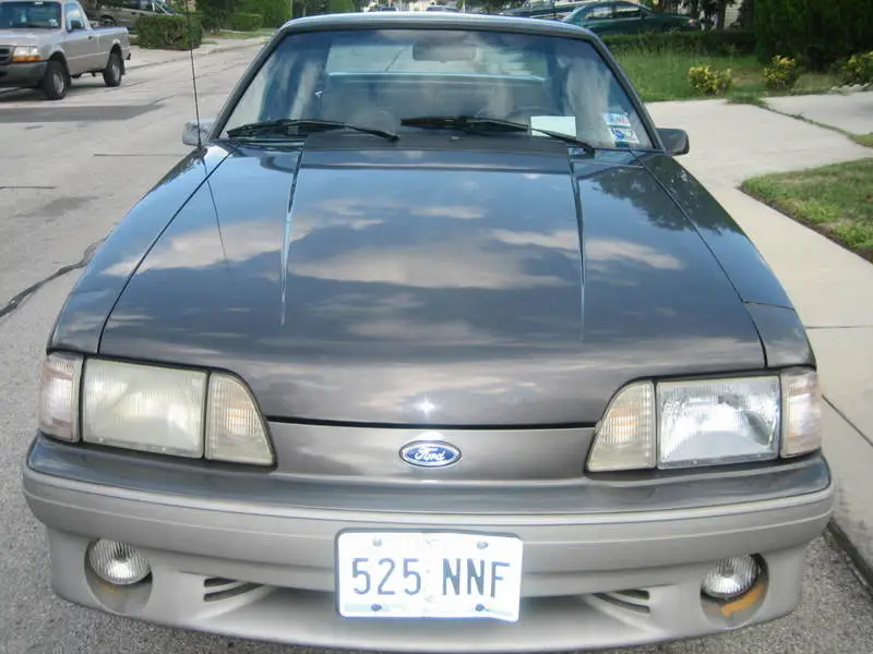

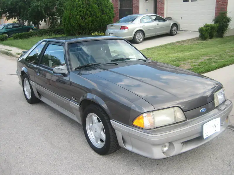

Well I have recently purchased a Fox Body after always wanting one. In the 3 months that I have had her I did mostly tune up stuff (MSD Coil, cap, rotor, plugs, Ford Racing Wires). On the performance side I have done a BBK H-pipe and some flows, a Steeda Tri Ax shifter, a McCloud dual friction clutch (not by choice), and my underdrive pullies are on thier way.
I ran her just like that, mostly stock and ran 14.5s with a 60ft of about 2.2. She had more in her but the traction was a major issue. Also that was with driving a standered for about 2 months, so go me.
Now I am wondering what would be a good start to gain some traction. I know I will be getting some drag radials, but not sure what kind. I want some that will stick very well street and strip, not some that will kill me in the rain. I guess I will leave it at that for now, here are some pics...

nice looking car. as far as traction goes. i would start with some upper and lower control arms. there are a wide variety and a wide range of prices. just pick one that suits your budget and get them. subframe connectors will help keep the car straight and keep it from twisting after launching it real hard a bunch of times. as far as drag radials go i would get the mickey thompson e/t streets. they seem to be a really good drag tire and are street legal. as far as drag radials that are good in the rain...that aint gonna happen. im sure there are some that arent bad in the rain but none of them will be like a regular street tire. good luck
