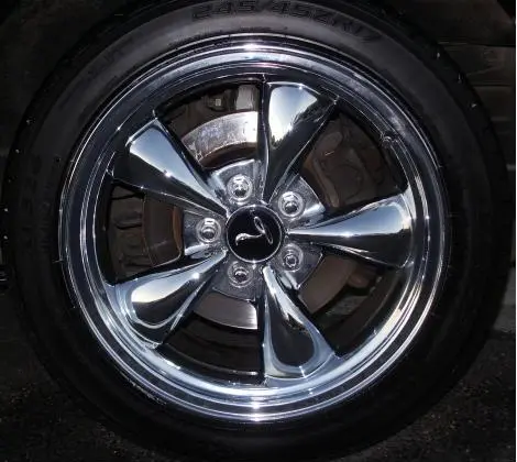

Also, how loud is the average tire noise? At freeway speeds (70 MPH) the tire hum was louder than the engine. Is there a way to change this, short of swapping tires/rims?

As far as the tire noise goes, what kind of tires does it have on it? Crappy tires can make a lot of noise. I put Goodyear Eagle F1 GSD3's on our 96 and they're really quiet. No decent tire should make the amount of noise you're describing. Are you sure that it is tire noise and not bearing noise?

I'll send the owner your suggestions on what to check. As for the tires and rims, see attached. They are 245/45 ZR17. Regarding the tire noise/bearing noise, what would be a good way to tell? The hum is definitely speed related, as when it is under 45 you dont hear it at all.
