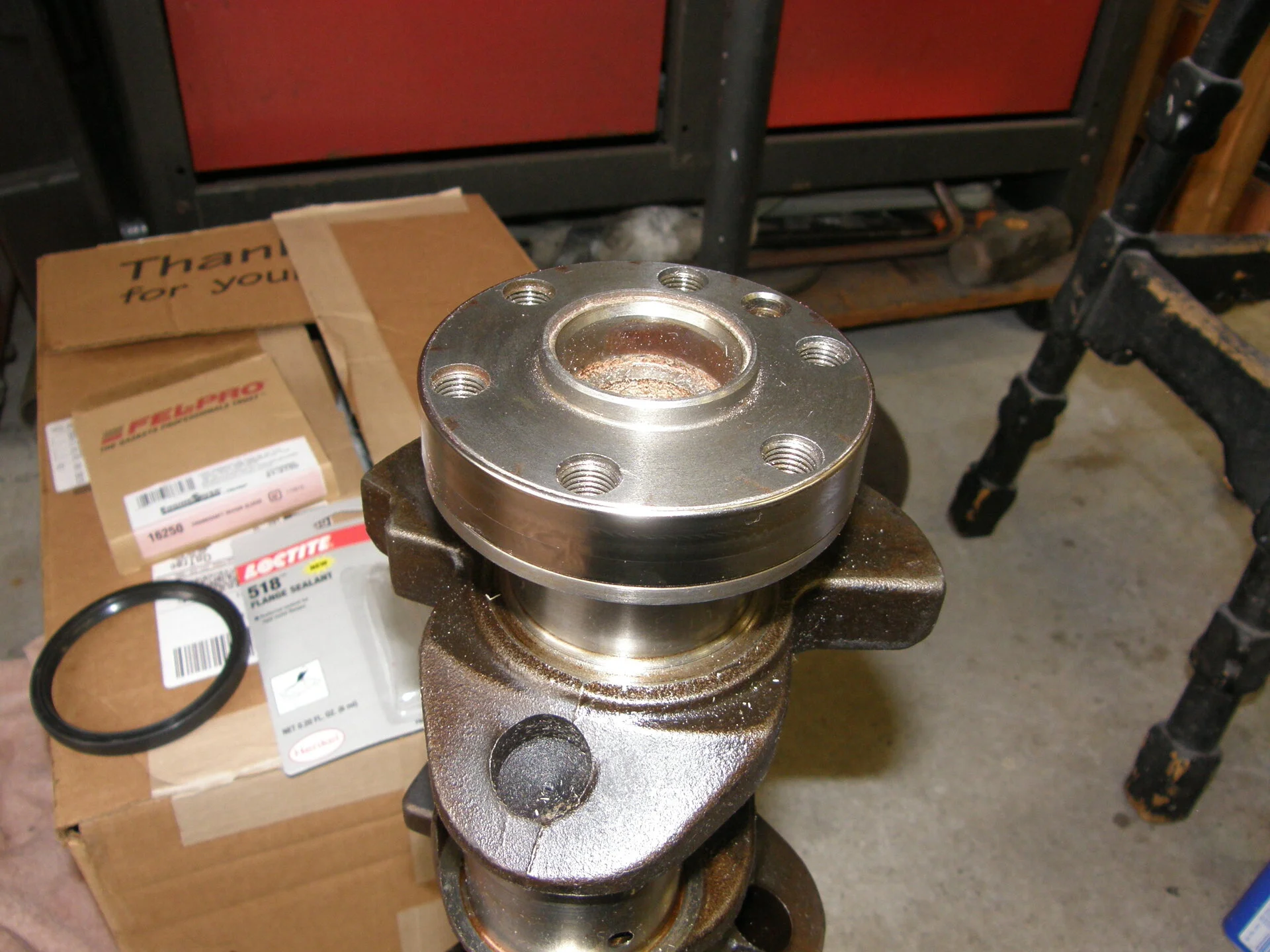

I just did this last week although my motor is out of the car. I installed the Fel-Pro crank sleeve.....
Fel-Pro 16250 crankshaft repair sleeve
Then I used Ford Racing's one piece rear main seal.........
Ford Racing rear main seal
As far as the flywheel bolts, I used a bit of this............
Permatex thread sealant
Hopefully, I won't have any RMS leakage problems. Time will tell!
