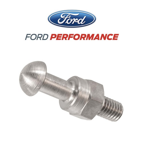

Follow up questions....
In the links provided, the release fork for my 87 is still available. The ball pivot is for 94 and up. They have no fixed pivots for my 87.
I found that LMR has both a release fork and the correct pivot available. Are they ok to use? I figure it may be better to buy a matched set than use the Ford fork with the lmr ball pivot?
Unless the LMR quality is no good.
I plan on ordering the bearings and some other parts this weekend so that would be good to know.
Thanks again

That Ford ball pivot is the one I used. It matched exactly to the original pivot in my fox bellhousing. I just had to swap the washer over.
Other sites list the stud as 79-04 except cobra. No idea why tasca lists ot
