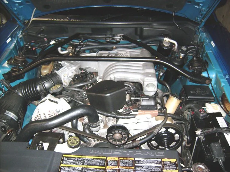

Well I added two cans of the refrigerant with the dye and noticed some dye present on the low side ac line. Here's a pic for reference. FWIW, this is NOT my car. I just snagged it from google.
See the low side connection immediately above the compressor? Well the dye is there, specifically on the side of the connection that right on top of the belt.
What should I do? Do I have to replace the entire line now? If I do, do I have to remove all the refrigerant first? I'd hate to throw away money like that, not to mention the install and cost of the new line itself. This might sound blasphemous but can I add some JB Weld on the connection part where the dye showed up? Or will that not work? Has anybody used JB Weld on an ac line before?

Just to clear up how the system works. The switch on top of the drier/accumulator is actually called the cycle switch. It is both a high and low pressure switch. It kicks the compressor off when the pressure gets too low, and when it gets too high. That's why your compressor keeps cycling at idle, you don't have enough gas in the system. If you have dye or oil coming out somewhere, that's where the leak is. Don't bother pulling one off a V6 and putting it on your car, that switch is pretty damn cheap, and there is no reason not to buy new.
Now here's a little reality. Anytime you open the system up, and drain out the gas completely, you have to have it evacuated completely, add oil, and have it refilled. A shop charges about $80 to do this. That high pressure line is about $80, and anytime you open the system, you have to replace the drier/accumulator, which is another $45 or so. R134A is about $6-$8/can. Always buy the store brand. It's all made by Dupont under patent anyway, so don't bother paying for name brand stuff. If you continue to leak out only 2 cans/yr, that means you can go 12 years just refilling it for the cost of repairing it. And that's if you do most of the work yourself. So if you are not analy retentive about everything in your car working perfectly, I'd just keep putting 2 cans/yr in the system.
