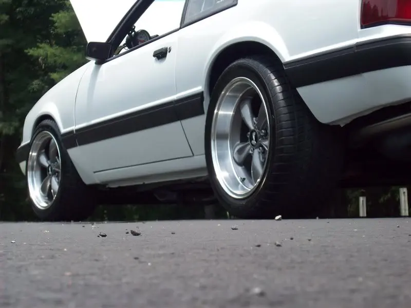

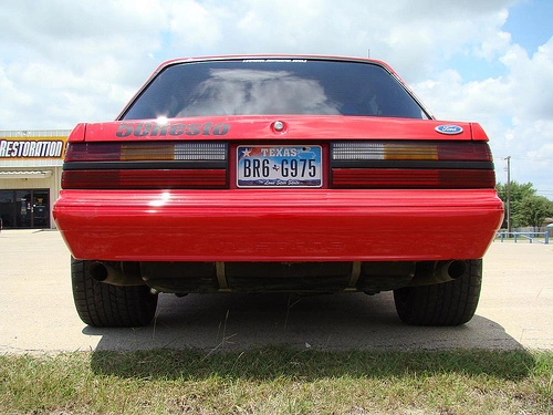

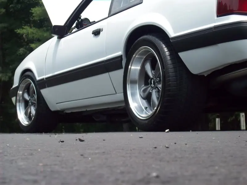

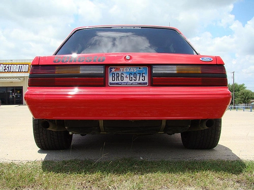

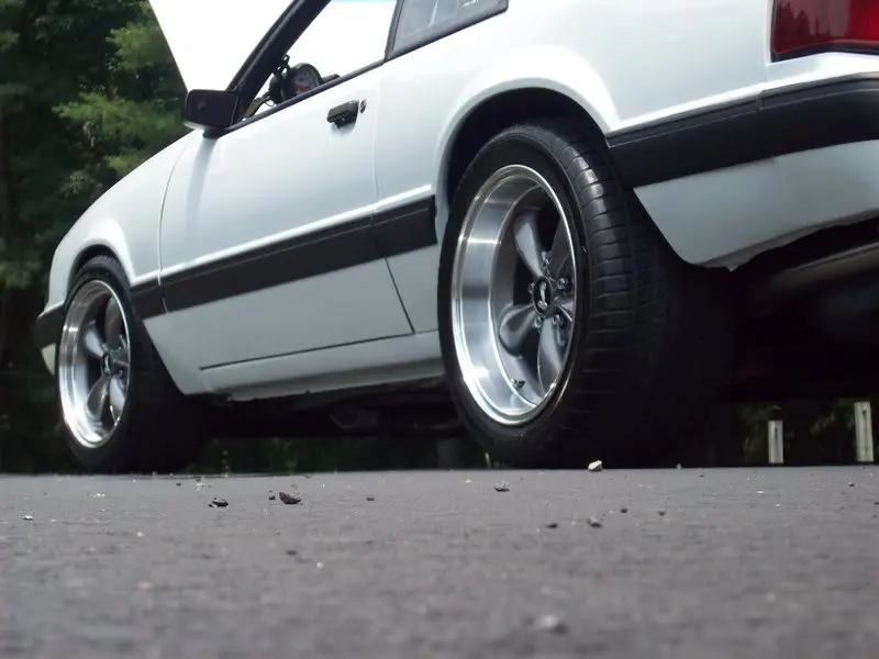

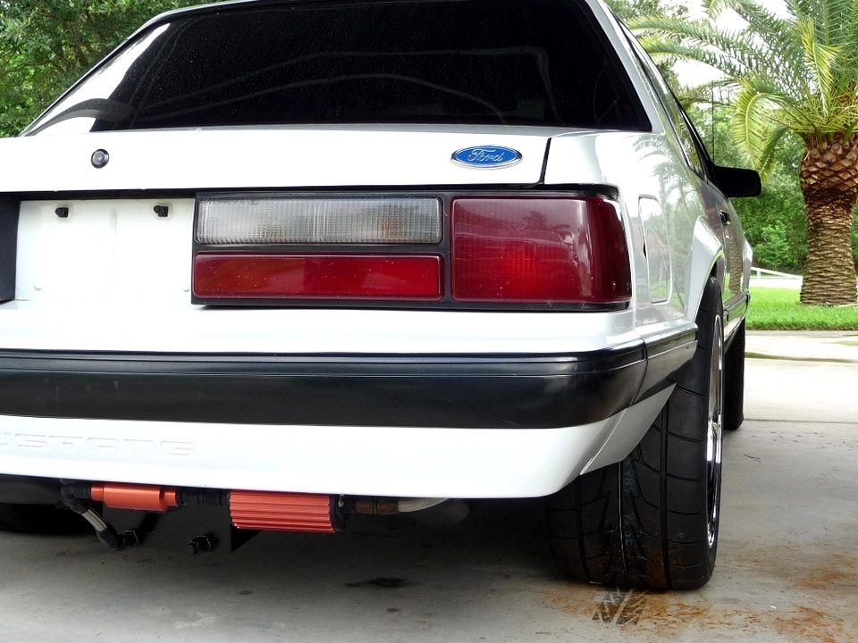

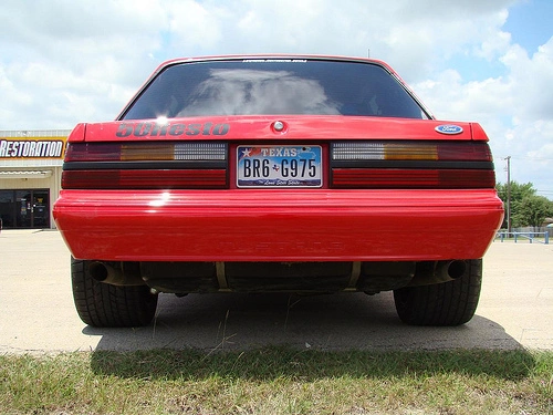

Massage the fender with that size wheel? More than likely.
I've never understood using a 10.5 wide wheel on a fox because your car is still only going to accept a tire that fits on a 9.
Because when you do get them to work, they look ohhhh soooo sweet!!!

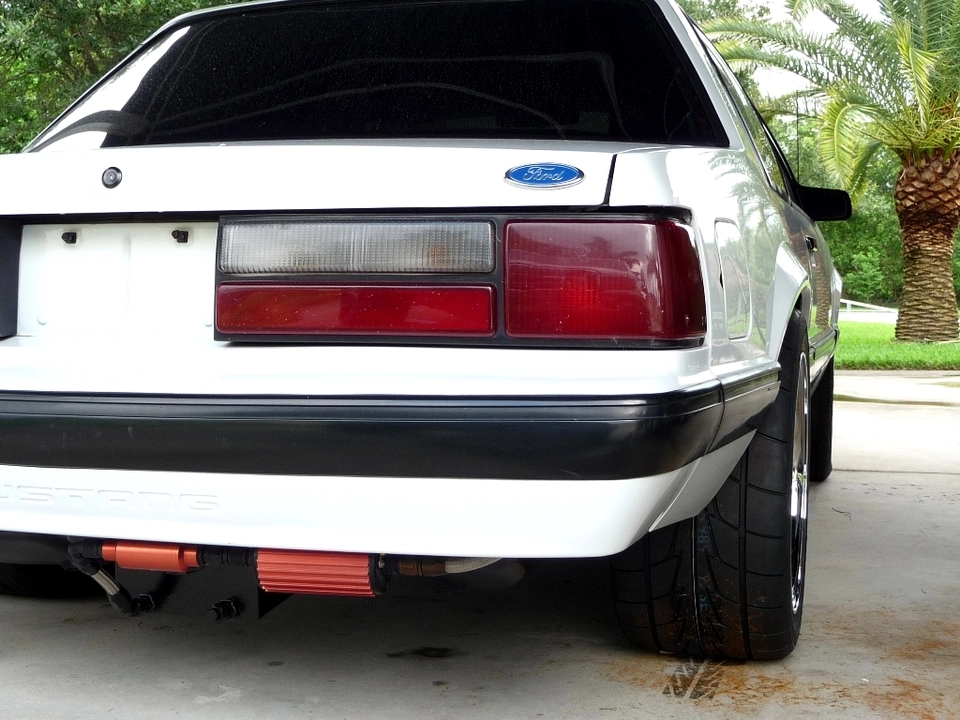

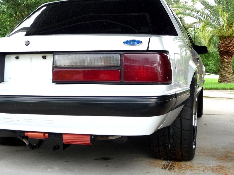

I've got 275's on my 10" rear wheels right now and you can bet when they're gone, 315's will be taking their place. 275's on a 9" wheel....yes. 275's on a 10-10.5" wheel...not a great fit.
