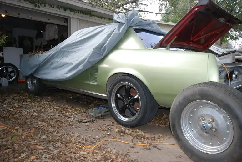

I am about to buy some wheels from a friend of mine. He has 4 17x9 black bullitts. At first I thought he just had 17x9s in the rear and the fronts were 17x8s but he has 17x9s all the way around. Anway, I have a quick question. I know the 17x9s should fit without issue on the back but I don't think they will on the front from what I've read. Is that true? Also, what is the widest 17" wheel that will fit on the front of stock 67-68s with out any modification?

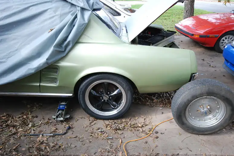

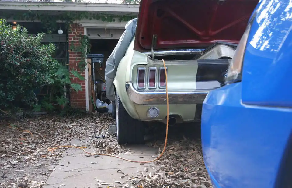

Well I got the wheels and test fit them, no spacer. What do you guys think?

Those wheels in the ebay link have 4.5" backspace which is the correct backspace for most of the classics (same as my 16x8 Vintage 45s).
So, these have different backspace than a late model wheel which is something like 5.9" or there about.
Thats cool. I didn't realize that they had that backspacing.
Yeah, You should be fine with the 17x8 in the front.
