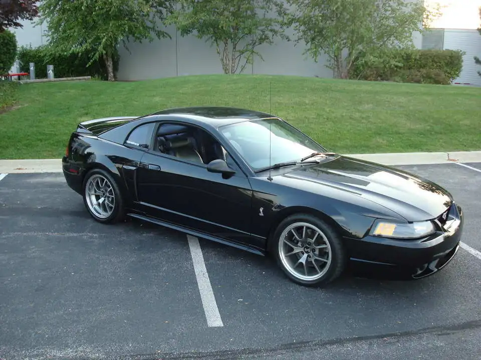

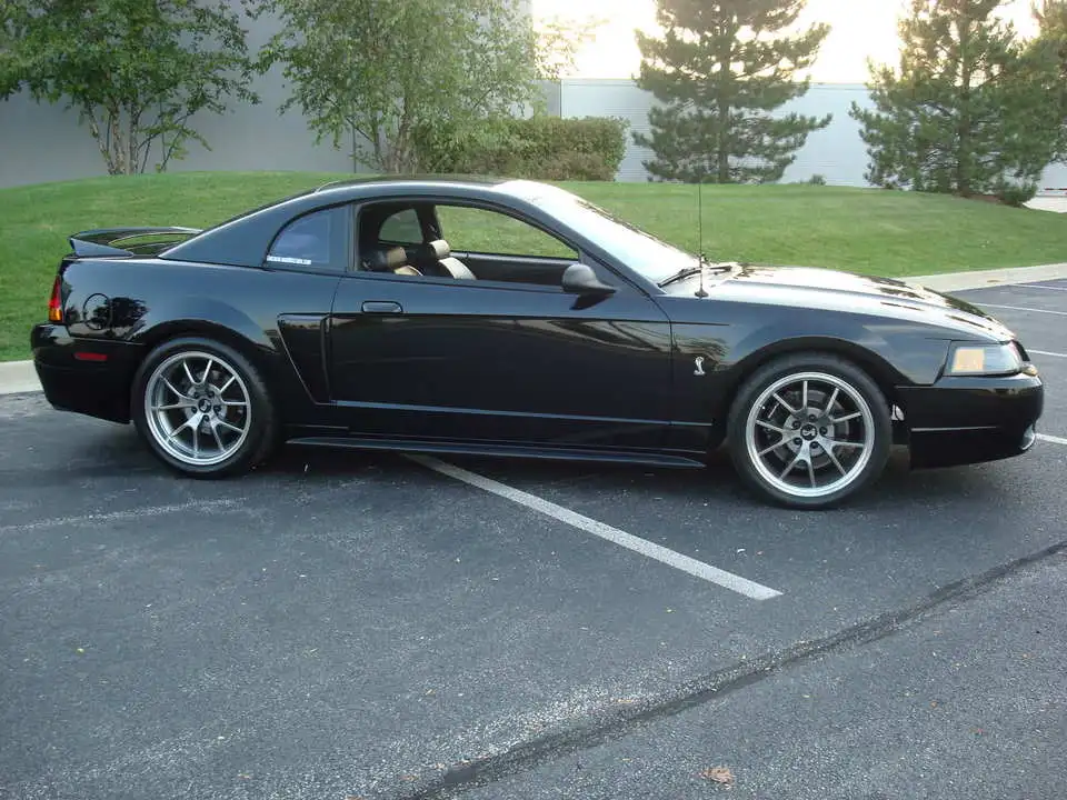

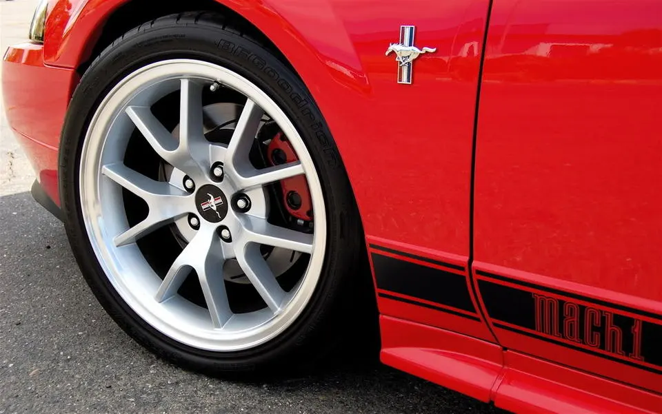

I have the 18x9/10 FR500's and actually run a 245 40R18 up front. Looks good to me and they are much less expensive compared to the 265 35's. I also think the 265 35's don't look right... not enough sidewall perhaps :shrug:

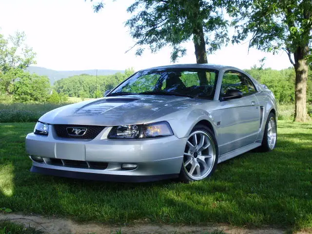

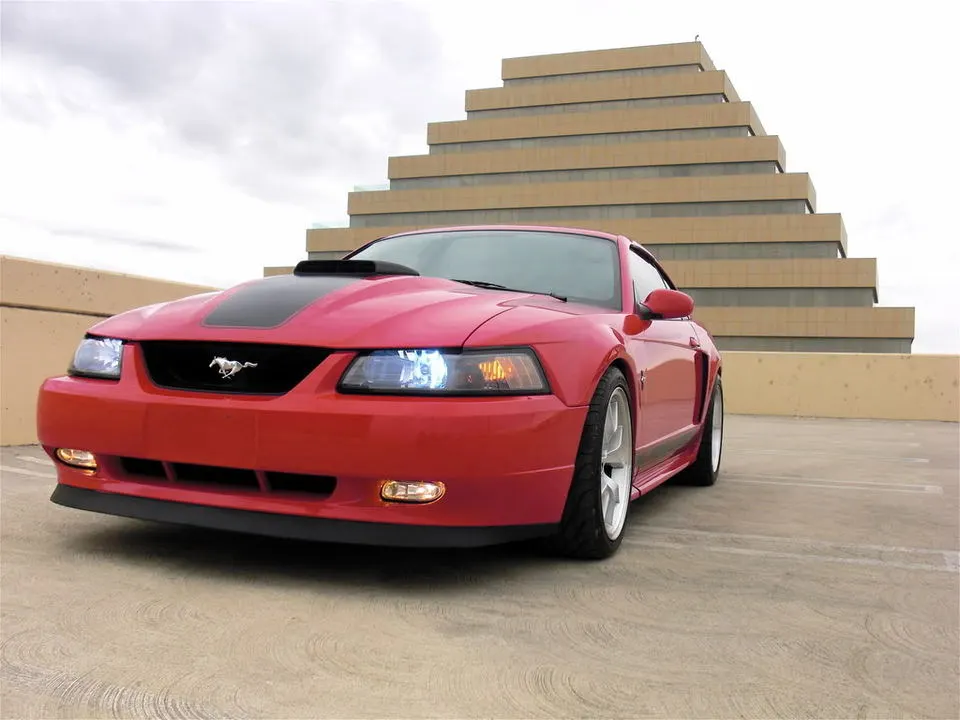

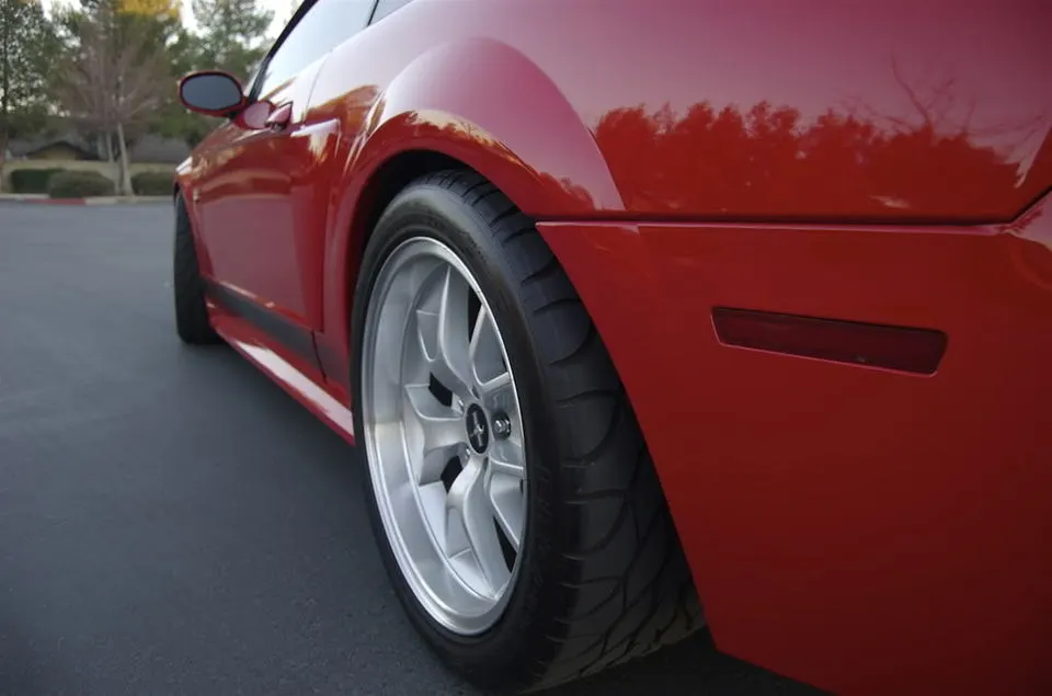

265/35/18 up front & 295/53/18 rear fit perfect IMO... No stretch & no bulge. What brand tire you go with will also effect the fitment & the look as well. If you go with a nice domestic brand tire like a Goodyear, or BFG, they will be a tad wider than an import tire like Nitto, or Sumitomo.
100% with Epic. I had 265s up front and now I have 275s. The 265s were better, thats what I'll do next time. 295s on 18x10s out back is perfect.:hail2:

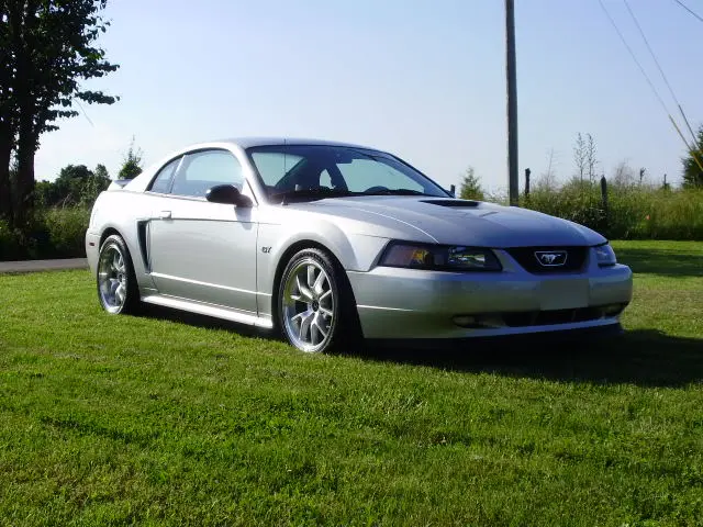

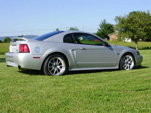

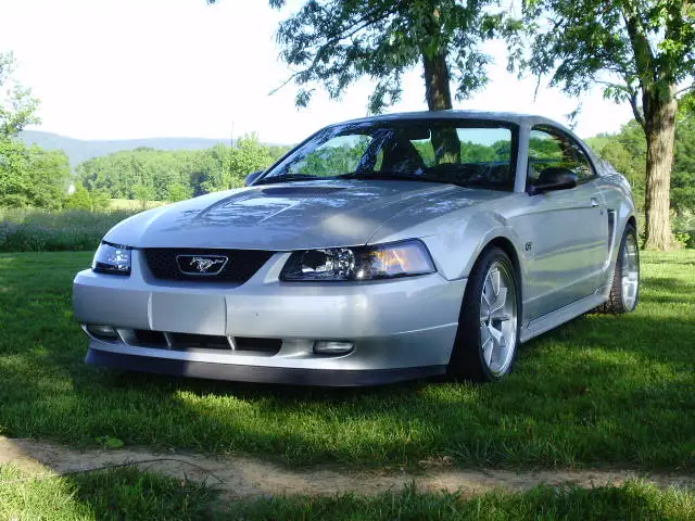

265/35/18 & 295/35/18 General Exclaim UHP tires
18x9 & 18x10s
H&R SS springs
ES isolators in the rear. no isolators in the front.
i HIGHLY recommend these tires. budget friendly and excellent manners.
