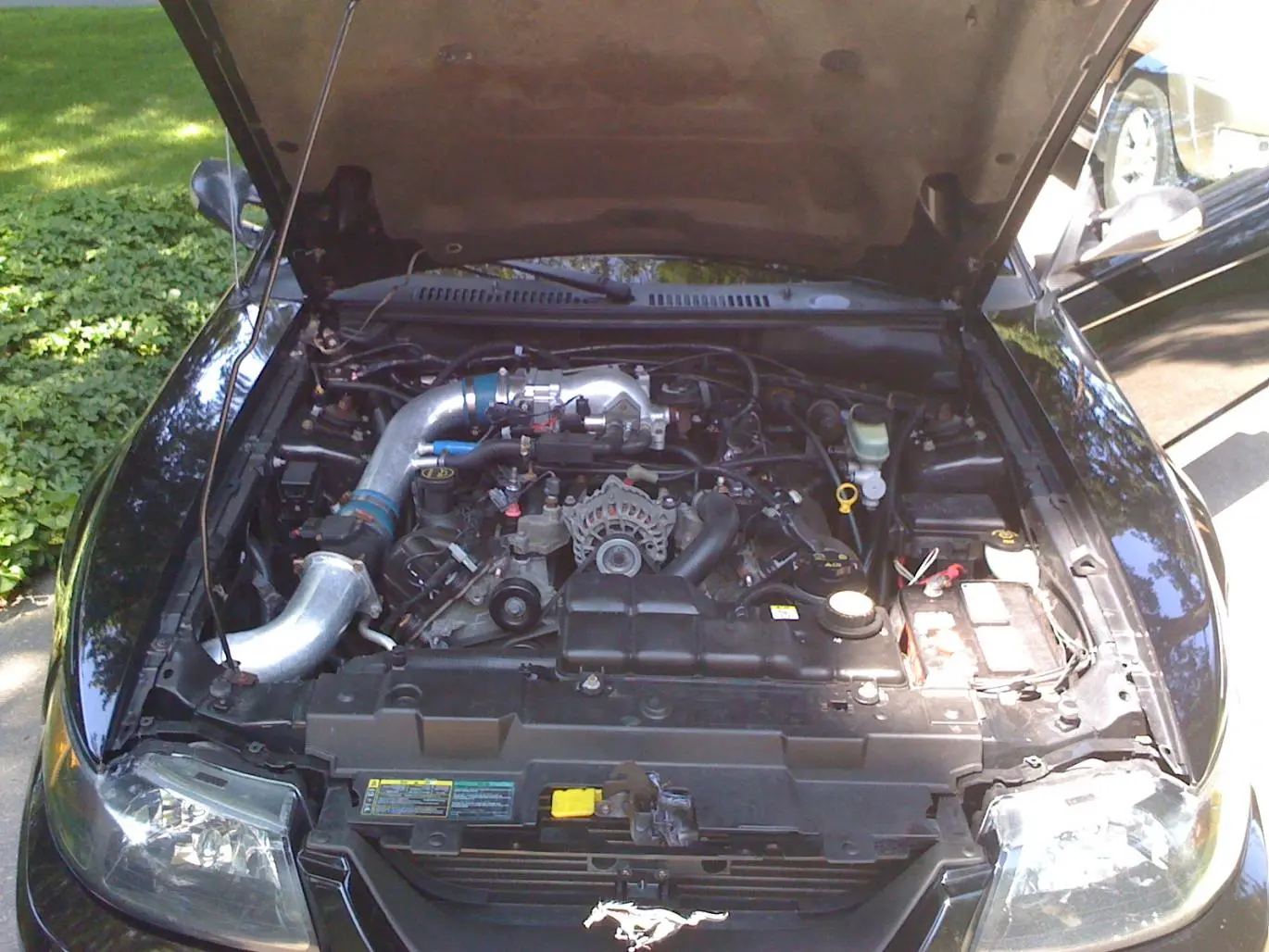

What type of CAI and Plenum do you guys think I have? I do have a 75mm dragon tb
Looks like a MAC, BBK or an e-bay knock off. Either way chrome CAI's FTL. You're better off with the stock piece in there w/ no silencer and a K&N filter because the chrome metal ones tend to soak up loads of under hood heat and transfer that heat to the incoming air
If you must have one your best option is the JLT or the K&N because they are both composite.
scratch that...after looking at the brentech its not that one either....not that it matter too much but brentech comes with black couplers and where the filter goes in the fender well is different....
maybe mac or ebay
