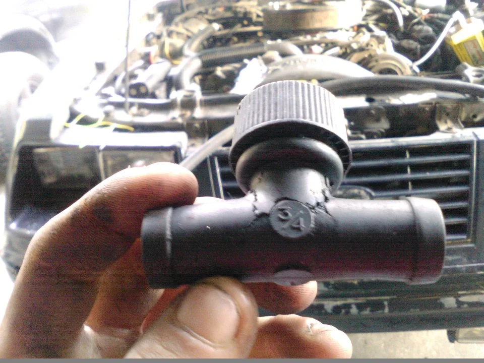

Note: this is for the sole purpose of getting to and from the part store on Friday morning. The car is not being driven on a daily basis and won't be driven before or after the part store run on Friday. It has other issues keeping daily driving from happening until this weekend hopefully. If the picture worked you can see the heater hose connection I had has cracked pretty bad. My question is will electrical tape hold water in for approx 3-4 miles. Should be 3 miles max. Or any better common items ideas that's better. I hate rigging stuff like that but I gotta do what I gotta do. I just don't want to get antifreeze all over the motor and everywhere. If it's not going to work no biggie. Just a bit of a bike ride carrying a few parts back. I only have the hose and parts for 5/8 at the house

eh, not really. hot water will melt tape right off. it looks like a hard part... what part is that? I would JB weld or epoxy it. or I would just walk/ride bike to the parts store

You'd be better off finding some tube, ANY tube close to the same o.d. and splicing the hose together. It doesn't need to have a cap. Tape won't hold , especially not at the center of a T joint.

I didn't concider the heat factor. Even though it won't get heated up all the way round trip it will still melt. I'm guessing the only heat resistant stuff I have would be red rtv. Exactly why I asked so I didn't do anything stupid that could hurt anything else. It's one of those connectors you can put on the heater hose to hook a garden hose to to flush the system. I only need something to connect the heater hoses together since the heater core is bypassed. In Florida it's not needed. And the one side has some wear on the hose where it has rubbed against something since it was to short.

MFE92 said:
You'd be better off finding some tube, ANY tube close to the same o.d. and splicing the hose together. It doesn't need to have a cap. Tape won't hold ****, especially not at the center of a T joint.
Listen to this guy, he's giving you some very good advice.
No tape, no RTV, no super glue. Maybe some epoxy, but a piece of steel, hard plastic, or copper tubing is what is needed here. Use a garden hose splice if that's all you can find handy.

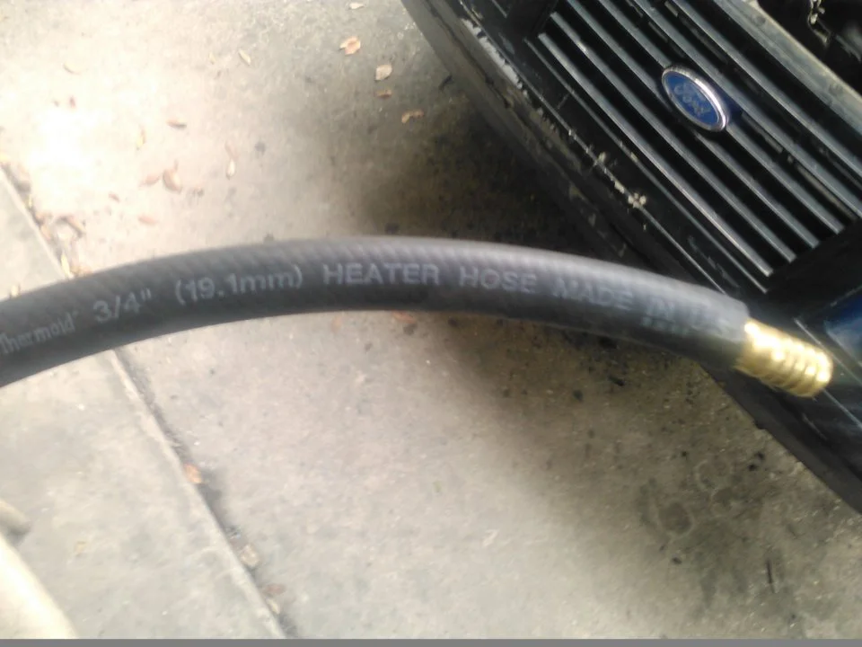

See I knew I had that brass peice in 3/4. That would've been real easy to have rigged it until I got some new hose lol. Even looked where it was at. Just overlooked it. Right on top in the tray for the box plain sight.
