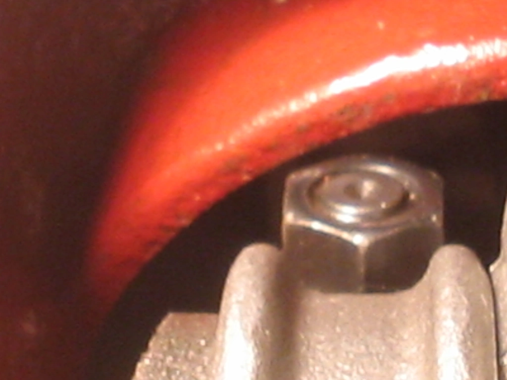

To add to your question's question? I, personally, installed a 331 stroker kit to my OEM '64 May built 289....no skirt clearance needed and I had about .075" clearance. It has been disputed, the skirt lengths are different. I offered this challenge a few years ago.

One you install the rotating assy. then begin rotating and marking the striking zones it would not take long. If the Dremel seems too slow, then, get a more aggressive carbide cutter and drill motor. It's not rocket science. You basically make a concave cut in the edge of the skirt allowing about .070-.080 clearance. If you do it, you'll feel like you have a stake and will be proud to say you had a part in building your engine.
