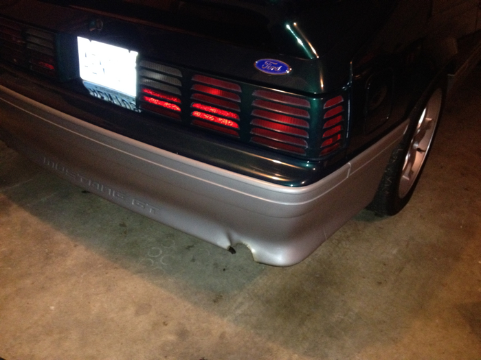

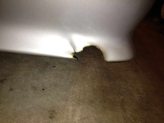

Unfortunately it caused a hole in the bumper last winter as the urethane was cold and 100 miles of a spirited run didn't like it

Such said hole in Bumper :(

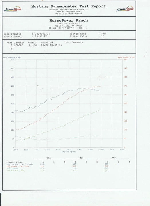

And I would be more than surprised if this were a lean pop considering how damn filthy rich it is between gears.... Dont of course have that dyno info, but you can see my AFR's at the end of my RPM range and they suggest a damned heavy amount of fuel. Happens when I am shifting around 6000-6200 as well
