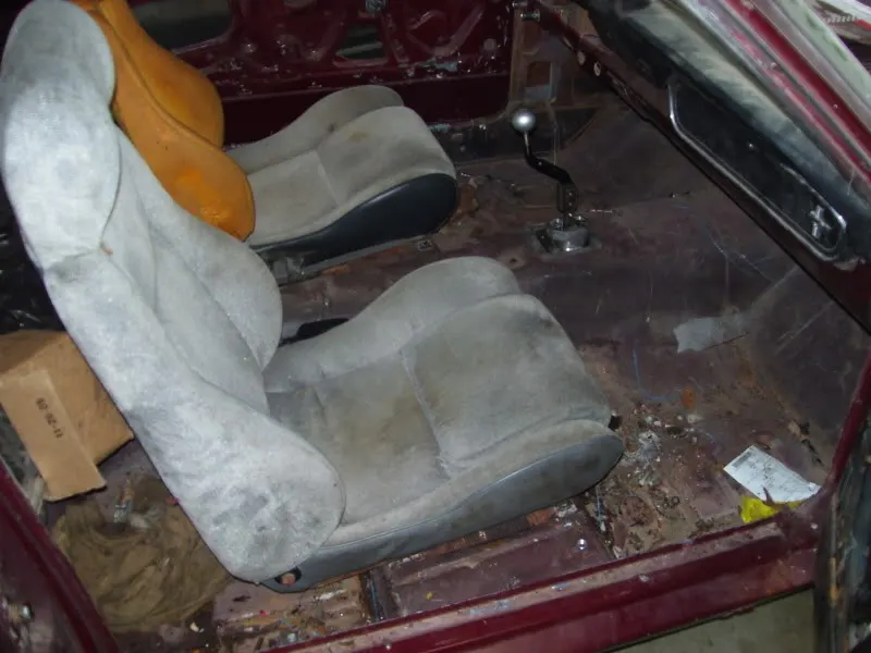

Hey i'm in big time need for help here... i have a pair of pro car rally seats for my mustang, and they go in in, but im 6'3" and I do not fit in the car with them in, even my grandpa who helped my put them in whos like 5'8 ish and he could bearly get in, and it was almost impossible for him to use the brake pedal with wiggly around. =/ i dont want to send them back.. has anyone out their ever done something like this? if you have put any kind of racing seat in a classic mustang and can help i would be so grateful.. i'm willing to consider anything that will work at this point.
thanks in advance.
-Josh

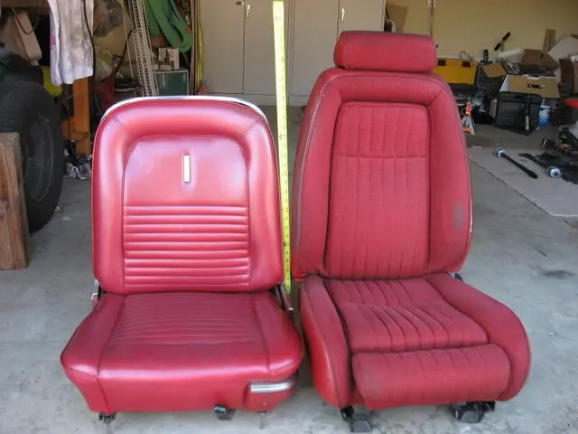

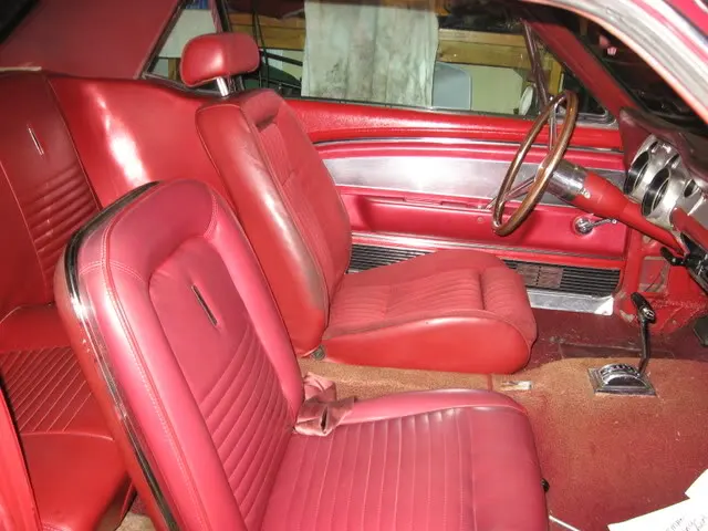

I'm 6'1" w/'67 and used foxbody seats ('87-93) in order to get upper back support, headrest, reclining seats and more comfortable seats with bolsters to replace my stockers. With the use of a piece of flat bar as an adapter and removing the 'feet' that came on the foxbody seats they are no higher than my stockers and much more comfortable just to give you an idea:
Jon
Thanks for the advice and the pictures. I will have to think about that. I'm not to sure i want to take the new carpet out and cut out the seat risers. =/ i'll think about.
thanks again!
Scudly: How did u lower the seat risers?
