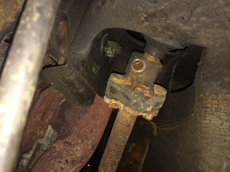

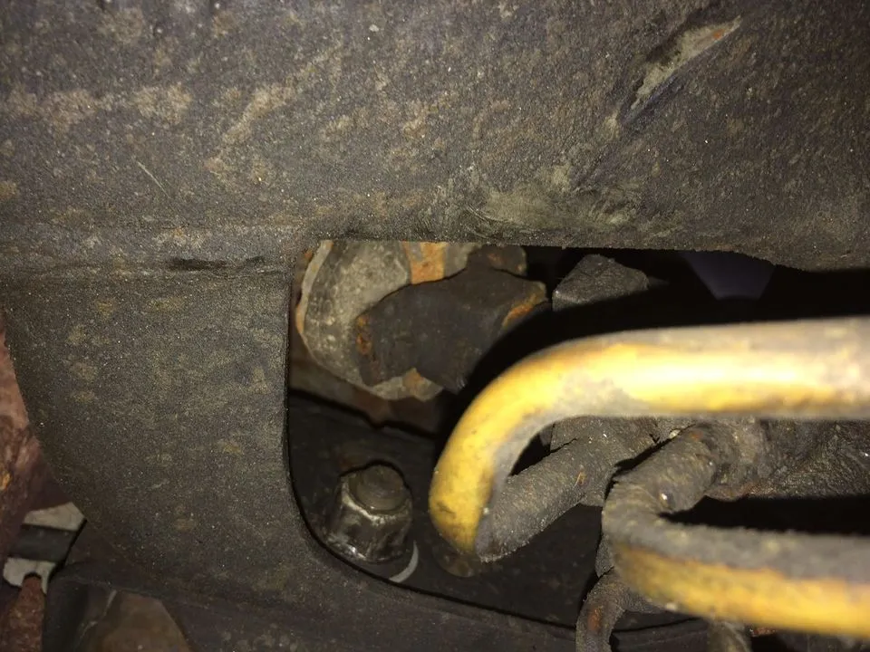

So I'm looking for some help, I'm close but struggling with the steering connection. I found 1 bolt 13mm that I fully removed but the rack still isn't pulling out. Since I'm helpful somewhat here is pics.
Well you removed the bolt but that is a soft brass clamp you need to spread it a little and collapse the shaft to disconnect. You will probably destroy your clock spring if you are not extremely careful also.
Reactions: JokerJamN
Steering rack is attatched to the k member by two long bolts.
Steering shaft by that one bolt, and is slip fit to the rack.
Looks like a lot of rust there.
maybe get some heat on it and pry it loose?
Thank you All! I was able to get it done. I had to get a screwdriver and pry the clamp apart then it pulled right out. Sat here trying to decide if I should do a new thread or add on, addon won.
