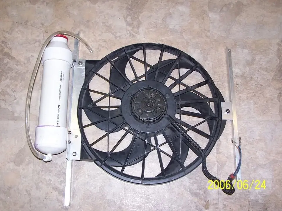

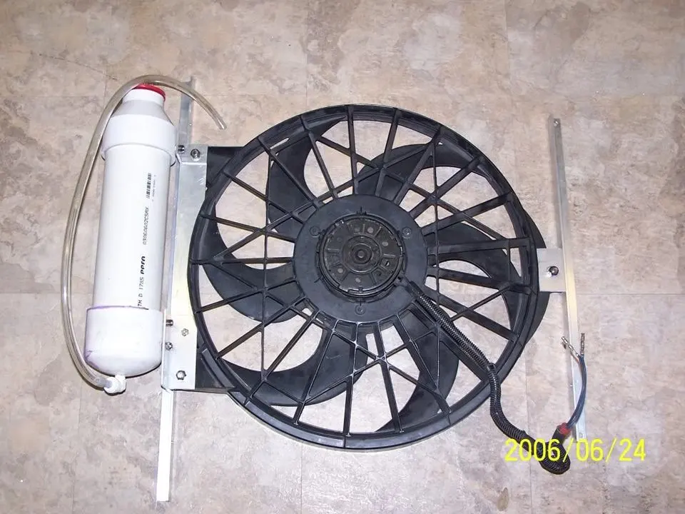

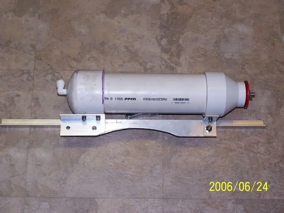

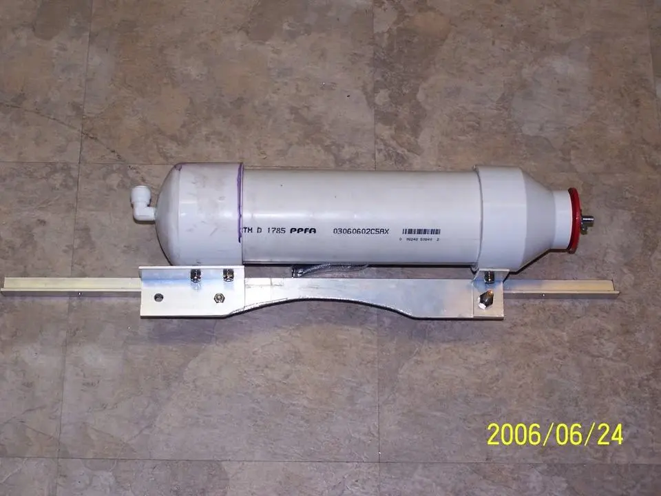

Some ideas...
The overflow tank is all PVC pipe from Home Depot. The overflow cap is also from Home Depot.
Reactions: GoldenEagle91
