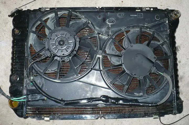

I have Ford Contour duel speed duel fans. They are controlled by a Hayden 3654 fan controller. Here is a picture of them mounted to the radiator.
Fan assembly was $30 at the bone yard and the controller was $75.
