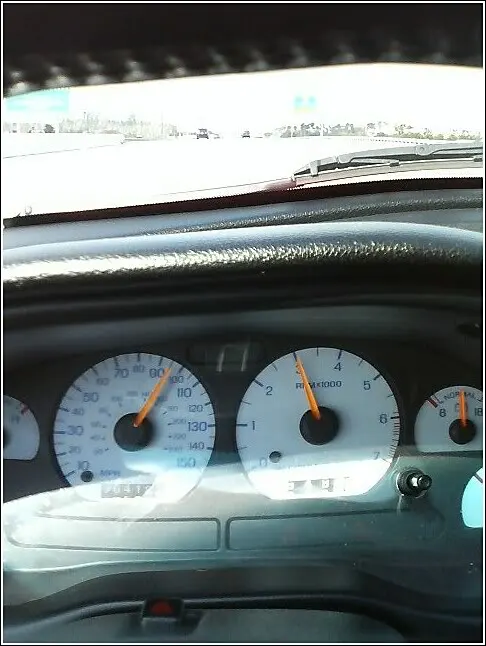

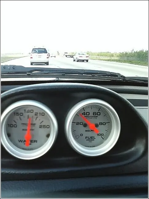

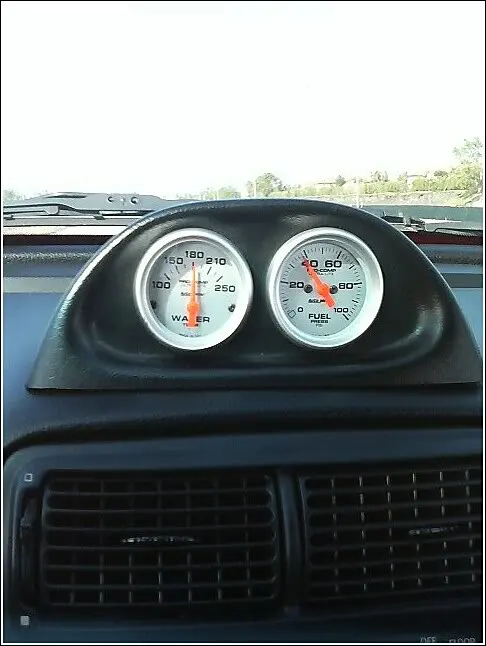

Probably a good time to upgrade to a 3 core aluminum. Fixing the stock radiator is a waste of time. It's made for high temps. A good aluminum will keep your cool under 195 forever, mine ran 185 in Florida summers. Mine was a C&R 3 Core from Steeda for $329.
This with a 347 stroker. This is in real time.
