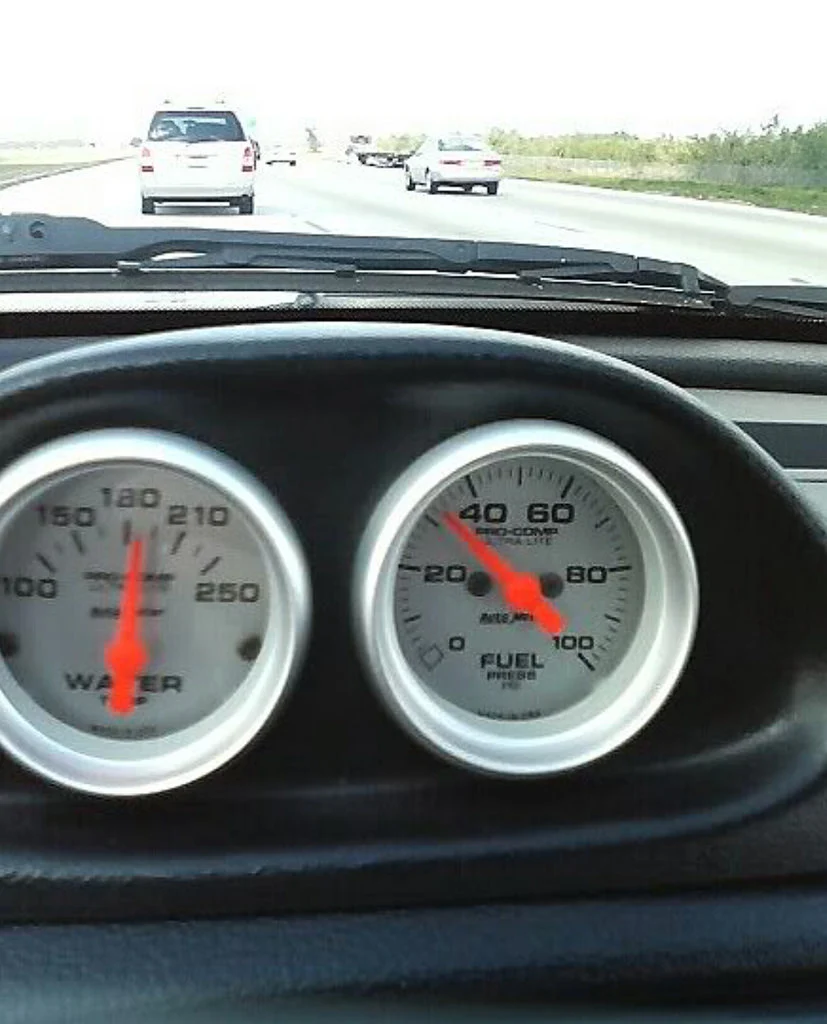

These pics are from July in South Florida, probably 98 degrees out.
The C&R radiator, 180 Stat and 80% water / 20% coolant with 2 bottles of water wetter.
I would like to purchase a new aluminum radiator soon myself for the 94GT project.
On the highway.
Untitled by jpjr501, on Flickr

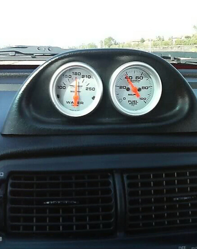

Stopped in traffic.
