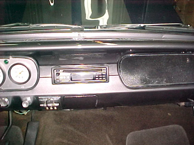

I used that tool where the bit spins really fast. I cant put my finger on the name, starts with an R. First i made an outline useing the the peice that the radio sits in. Then used that tool to cut it out. BTW, I think Virginia Classic Mustang sells dashes made to put new radios in.
mine
i used a dremel tool to cut it. i went thru about 100million discs but its easy to control. i think if i had my cordless sawzall back then i would have used that to make the horizontal cuts.
