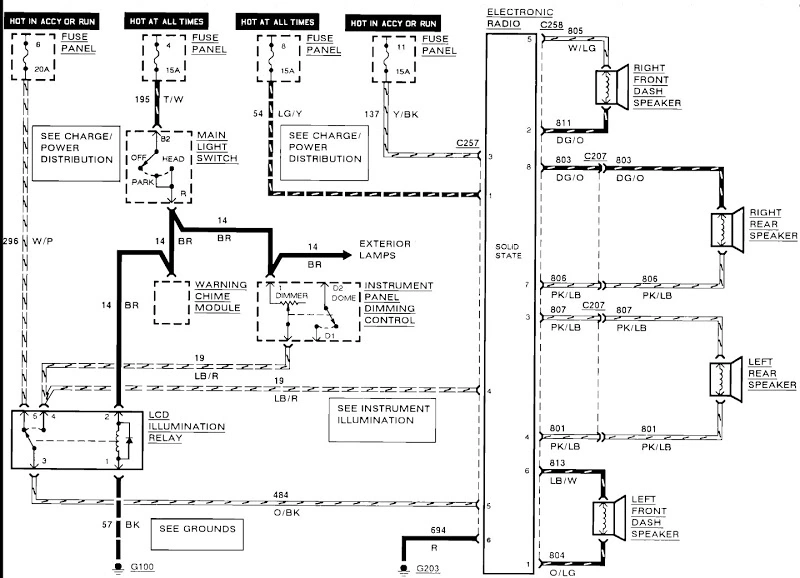

Light green/yellow stripe - Battery (constant pwr)
Yellow/black stripe - Acc (power when turn key)
Orange/black stripe - Day/night Ill.
Red - Ground (Im not positive on this one but pretty sure)
As for the speaker wires I cant help.. but you can use a AA battery to find out. Just touch each end of the battery with the wires - you will get a humming noise out of the speaker they run to.
Good luck
The battery idea is a good one, I'll have to try that.
You forced me to finally subscribe to alldata. In conjuction with the last link, which tells you which pin is what, this tells you which wire is what
