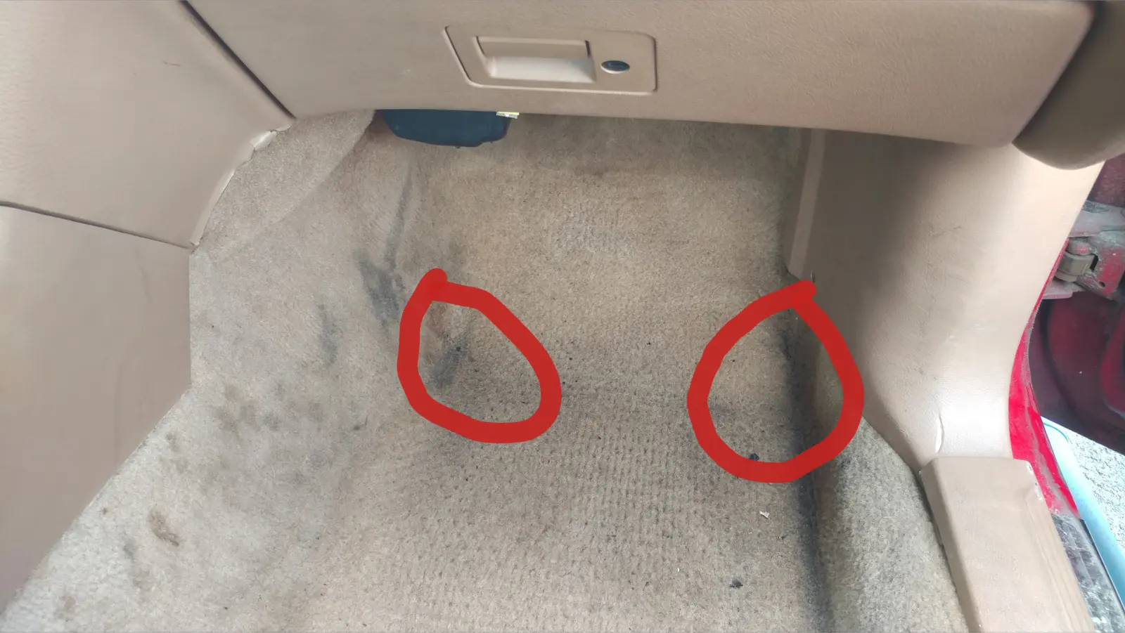

Hey guys, question regarding my '94... I'm getting water in the passenger floor board when it rains. Before there's enough water to accumulate, the bottom of the floor mat is wet but not the top. Accumulation starts in the marked spots:

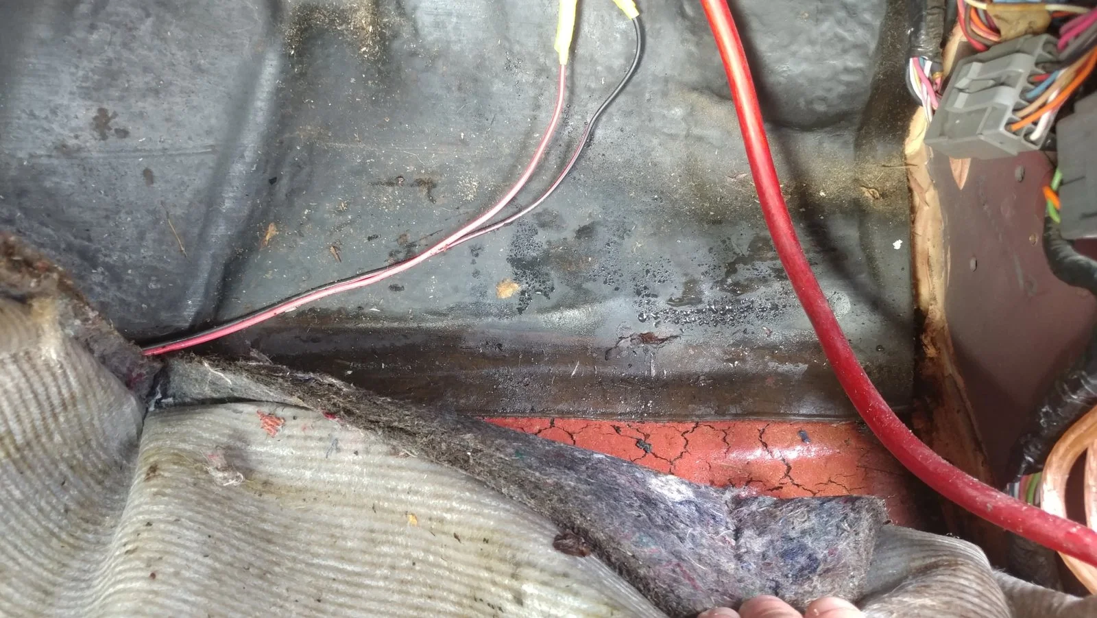

the left and right walls are dry, only the floor is wet... if i pull back the carpet we see some significant wetness

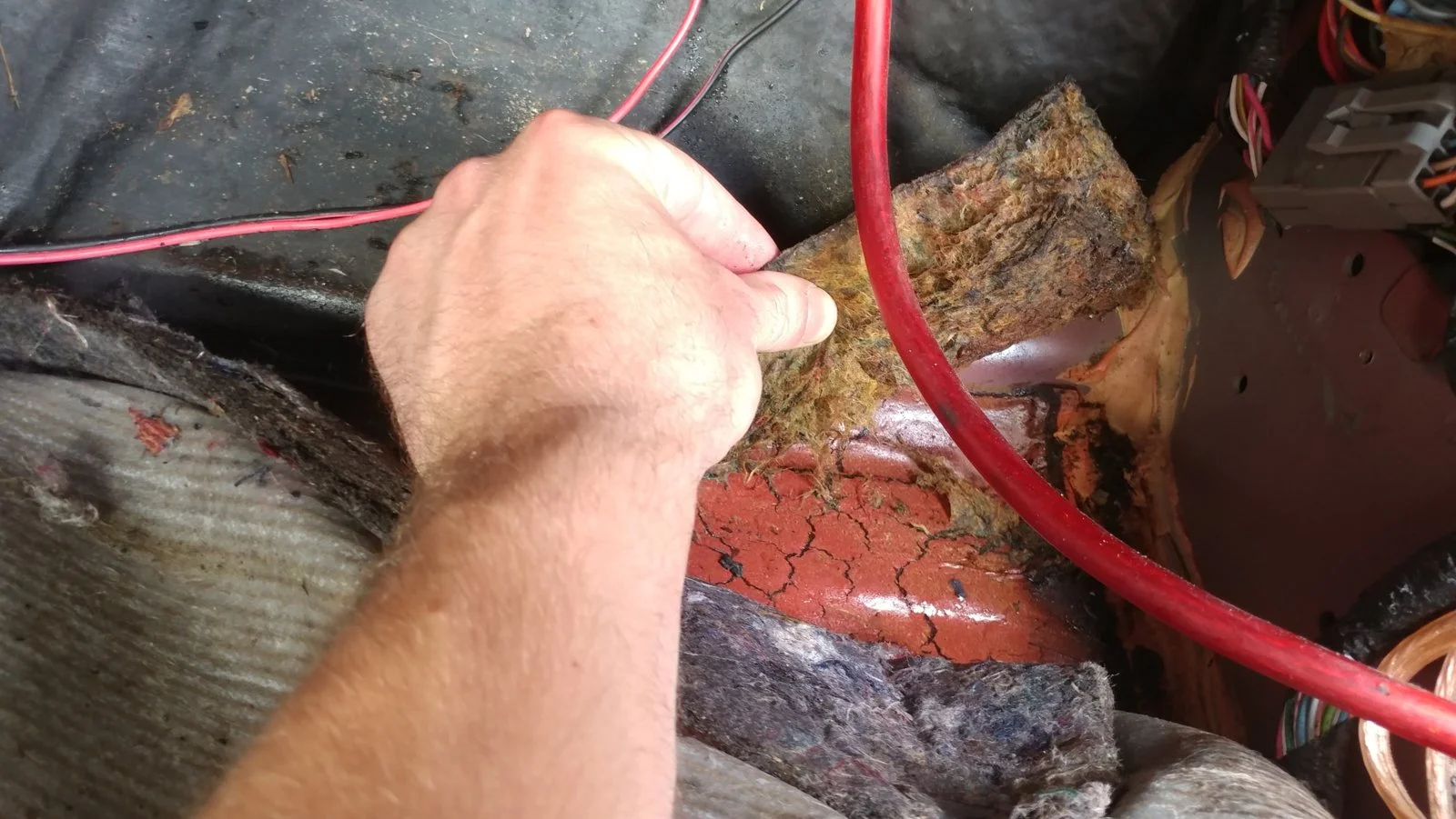

I'm thinking that black material should be snug against the floor, but it isn't and lifting it reveals the insulation underneath is very wet...

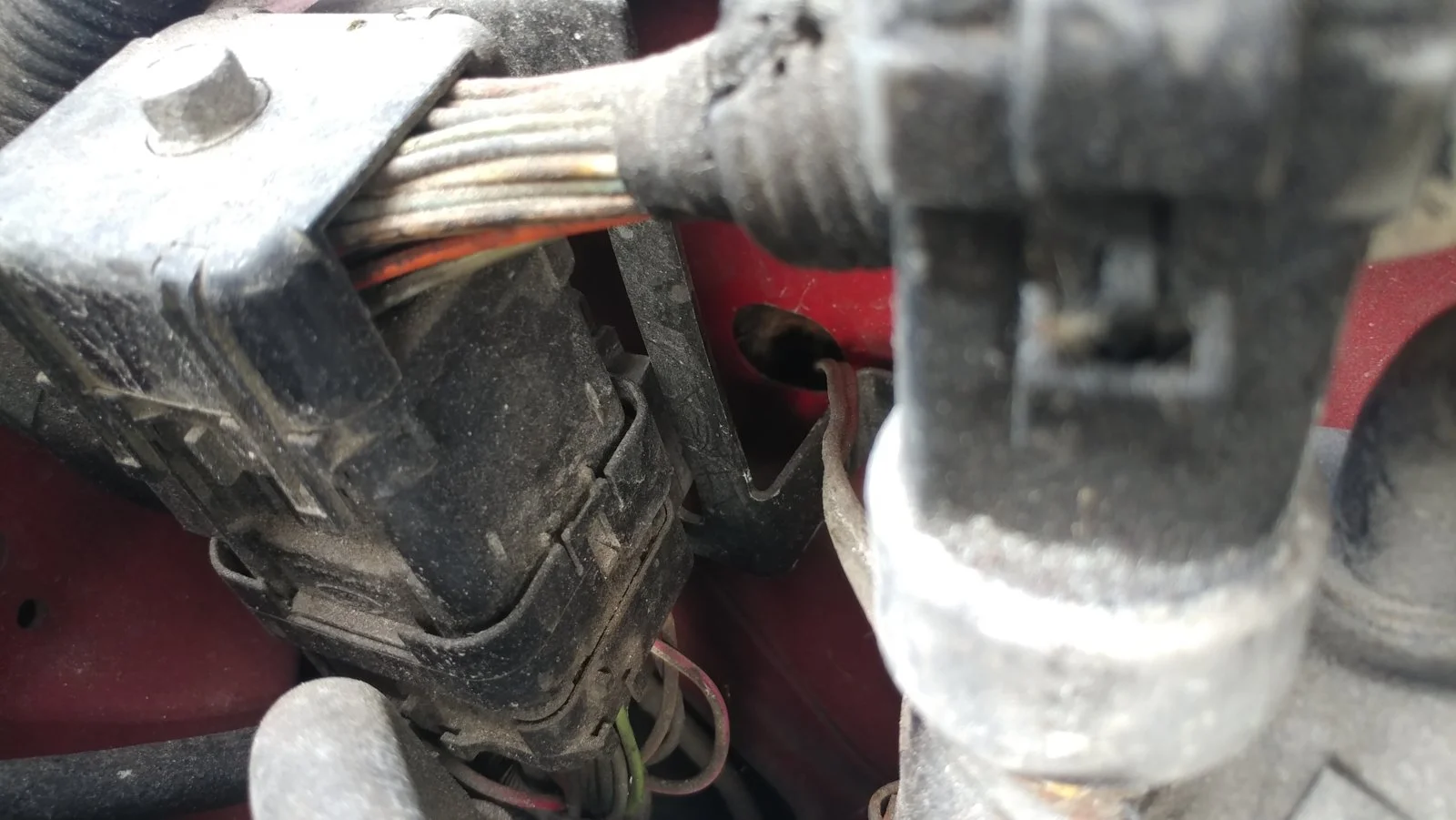

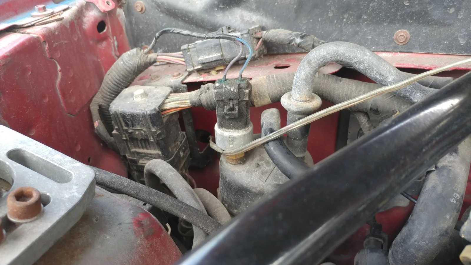

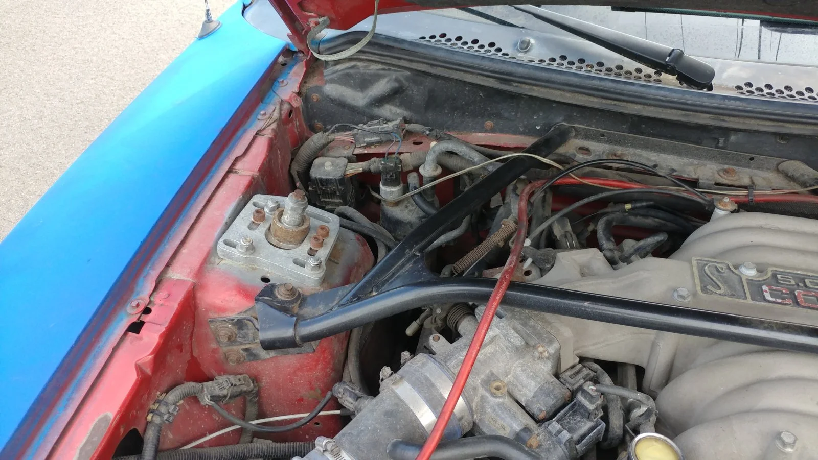

So, firstly, thank you everyone for the replies! Just now I spent time looking at the previous owner's (non-functional) sound system set-up. Two wires were running through a hole on the passenger side of the car out to the battery. In the images below, I've already pulled the large red wire out of the interior, now only the silver wire runs into the car...

This may seem like a silly question but... is that hole supposed to be there? You can sort of see the insulation behind it, I'm wondering if rain water isn't getting in and running down the cabin side of that wall. Thanks again guys.
Reactions: General karthief
Any hole in the firewall is going straight into the inside of the car. A stereo isn't worth flooding the car so I'd take those out and put a grommet in it and see what happens. Or until you can find a grommet just put a piece of duct tape there for testing (can't believe I'm saying this). Water inside the car is bad news.
I put duct tape over it temporarily to be sure that's (the only?) leak. I'll need to come up with a real plan to cover it durably, some of the pieces in front will need to be moved out of the way, can't really get my hands in there as it is.
