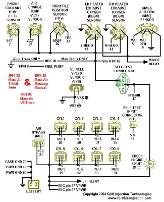

As for now I'm pretty much sure it's the mass air is either just dirty and or shorted out. That would explain the left bank reading lean and not the right being triggered and the mass air 4.5 v during the last 80 warm up cycle. Sitting all night then turning her on trying to take off, it will hesitate like it's going to shut off (late for work only). Heres a pic for any body who needs the diagram for the main harness
Wow, nice pic. Thanks, that is very helpful. See the wire coming in that also ties into the o2 sensors. THat is your ref signal, otherwise knows as your reference voltage, 5V all the time. The sig rtn is the return signal, which varies 0 - 5V. But at 0, that means an open, and 5, that means a short. it's usually in between .5 - 4.7V. If you seeing higher or lower than that range, you have a dirty or bad MAF sensor. If you are seeing 0V, your ref sig could be missing, or the ground wire is missing. A simple probe w/ a DVM will tell you that. But you will have to backprobe the sig rtn to see it in action (while car is running of course.
But remember the KISS method. Keep it simple stupid Try cleaning your maf first....
