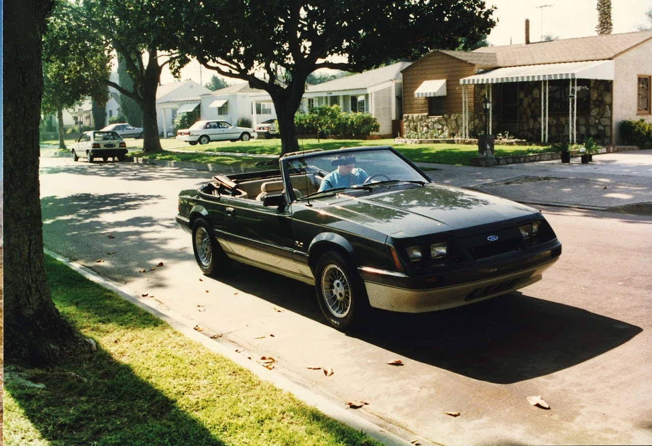

I used to have a 85 LX Convertible 5.0. It was Auto/CFI I swapped in a 5spd and MAF EFI motor along with turbine wheels. I sold it a long time ago and it is one of the cars I really miss. Looking back at it now it was a really rare color; Dark Sage, tan top, tan interior, but it also was two tone (tan below the belt line). Was that an option back then or was it a dealer thing? I bought it from it's original owner and didn't know enough back then to ask about it.
Here is a pic:
I loved that car, even when the plastic lines for the convertible top broke and spilled fluid all over the floorpan/trunk and the old CFI motor cracked a cylinder wall driving home at midnight.
I have been happy with my 2013 GT but I have a feeling another Fox Body is going to be sitting in my garage soon (low option LX Notchback is what I really want, but it's tough to find).

I'm not sure about the two tone color, let's ask @Mustang5L5 . He has some brochures from back then.
What do you think Mike?
Sage green is almost always the rarest color. It wasn't too popular back then. I love it now though.
Reactions: TType85
The tan interior and top was a thing. I had a pic of an 87-89 GT with the same convo.
I'll have to check the brochure about the bottom trim. Not sure I have 1985.

I don't recall seeing that two tone theme until the 87 style GT cars came around. I could be wrong, but I fell pretty confident saying they didn't come that way in 85-86. That car has wheels off of an 87 up GT, stands to reason someone painted it wanting the paint motif to match the car the wheels came from..:shrug:

I put the turbine wheels on it. It had the standard LX wheels 14"? Wheel "G" from here: http://mustangattitude.com/cgi-bin/...anuf=Ford&model=Mustang&smod=&page=17&scan=17
Looks like on the next page, charcoal gray was available as a two-tone color on the GT's and LX hatch.

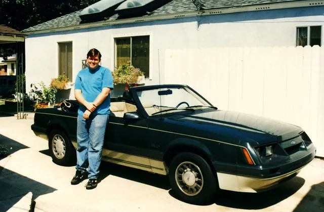

I haven't seen the 2-tone anywhere else on the older foxes so it may have been a dealer thing. I miss that car.
EDIT: here is another pic of the day I got it. Damn I feel old now.

Dark Charcoal was the only 'lower accent' (aka "tu-tone") paint available in 1985. It was only available on LX hatchbacks and GT hatchbacks painted 1B, 1E, 2A, 2R, 3V, 8L (LX only), or 9L.
Your door tag and buck tag will tell you the original paint color(s), including whether it had tu-tone or not. (1985 tu-tone = "XP" on door tag, "TT" on buck tag)
