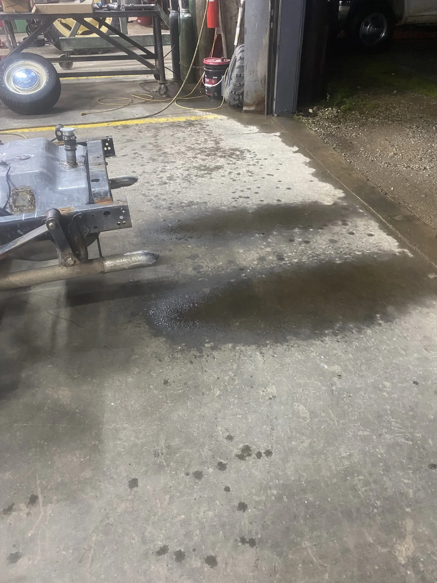

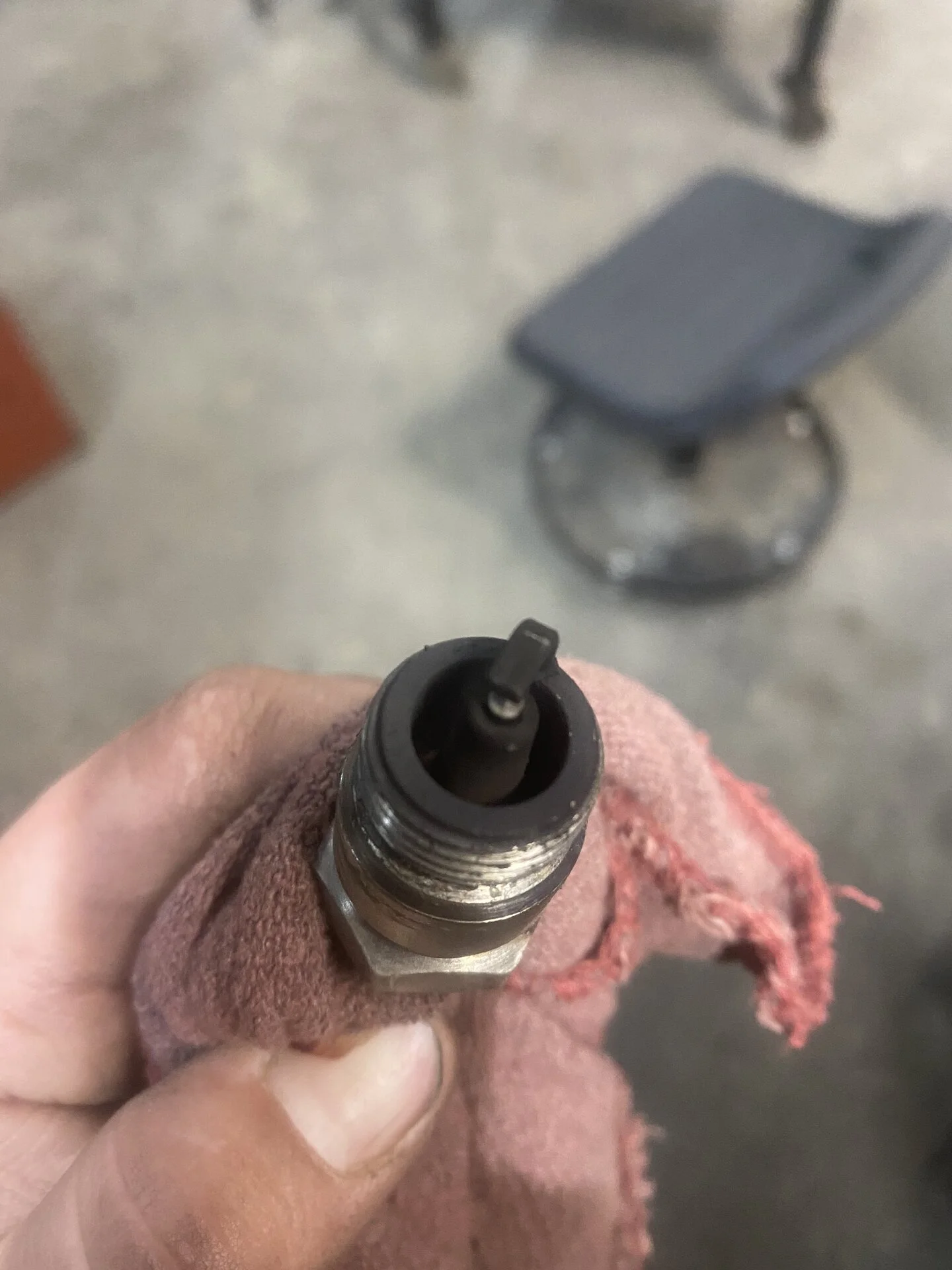

Hello. I actually have a 5.0 in a 68 Ford F100 that I put a mustang fuel injection setup in. It has been quite a journey getting it to this point however I’m having an issue with it starting, and it is running rich. It doesn’t hold pressure at the fuel rail so I have to cycle the ignition to build pressure before I start it. Then as it warms up while running it starts putting gas out of the exhaust pipes enough to make the floor wet. I only have codes 42 and 92 when I do a KOER. When I do a cylinder cutout then the first round it is cyl’s 7,6,5,3. Second round is 6,5,3,1, and 7. Third round is 8,7,6,5,4,3,2, and 1. I used a Ron Francis wiring kit. I bought all new sensors, a reman AL9 ecm, and I’m running a factory fpr. The motor itself has 27,000 miles on it. I bought it remanned from Surefire 4 years ago. It had a 3 year warranty and waited until the warranty was out because I wanted to change heads. It’s an early model 302, and I couldn’t afford to change heads, but I did have to swap the cam out to get the right firing order. It has a 351W flat tappet RV cam. I’ve got a video of it running if that would help anyone. I’m at a loss and desperately need help. Thank you.

Did you verify that fuel is exiting the tail pipes?
I doubt there is that much condensation in them pipes. Don't run the engine at all and change that oil out asap, squirt some clean motor oil into the cylinders. Now on to the problem.
Oh, and change them plugs!!!!!
What is the static fuel pressure? How is the fuel system setup? In tank pump? Return line? Timing? Injectors firing at the right time?

Looks like you have multiple misfires all around. That's why the numbers keep changing. Every cylinder is misfiring for some reason.
So many possible reasons though. Can you tell us about the engine?
Test each injector individually using a spare rail
Make sure the fuel pressure regulator diaphragm holds vacuum
I don’t have a spare rail. I do know the fpr is holding vacuum.

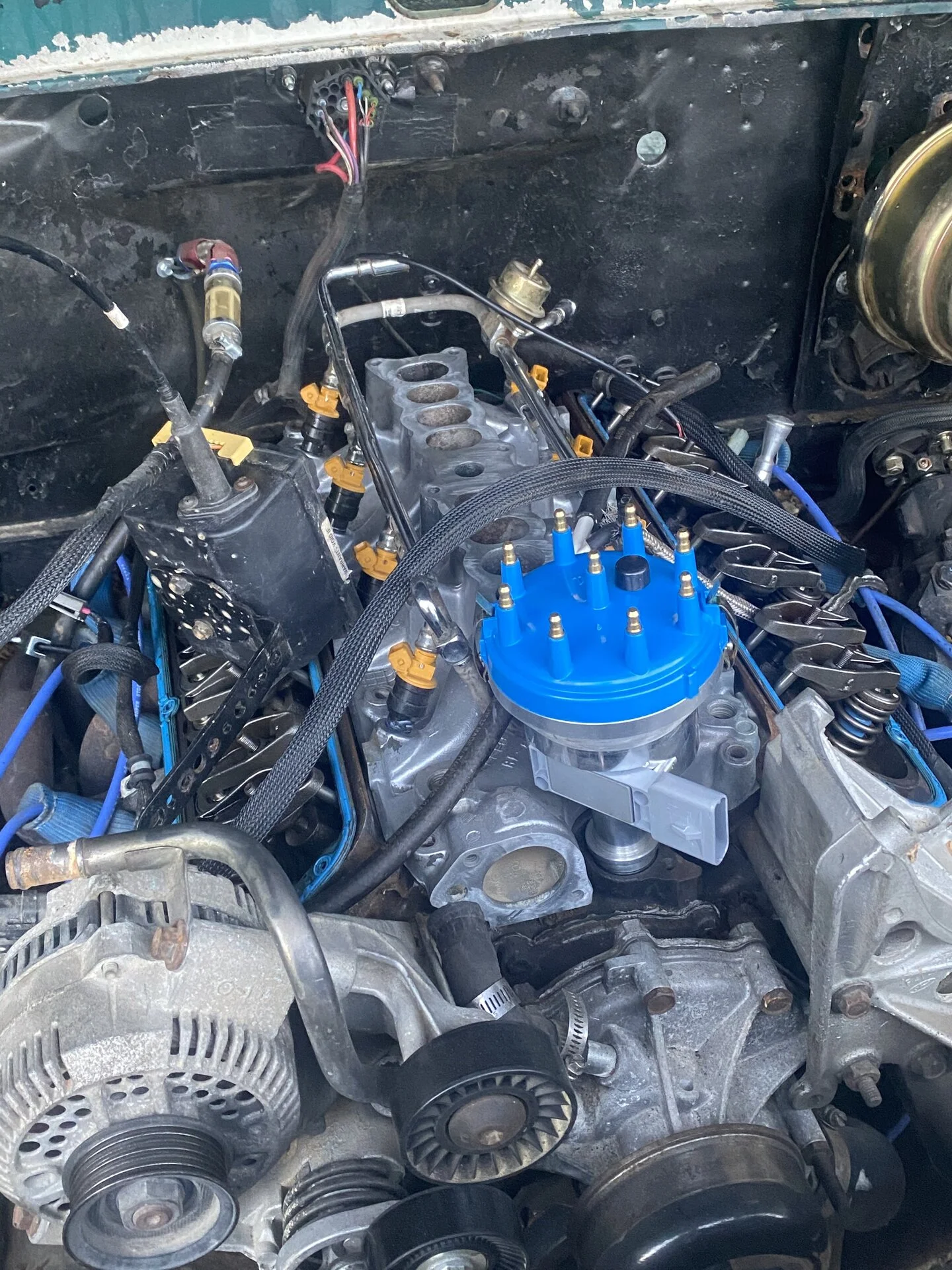

I was going to snap a current pic of the engine today, but my wife got admitted to the hospital last night so I’m not at work today, which is where the truck is. I do have a pic with the plenum off this was mid build. With this pic you can see the fuel rail setup. I’m also putting a reference pic of the truck itself. Just because, well why not? I sure do appreciate all your help.

What is that fuel rail off of? That's not a typical 86+ Mustang rail.
I don't think it has anything to do with your issue but just trying to understand what parts you used to put this together.

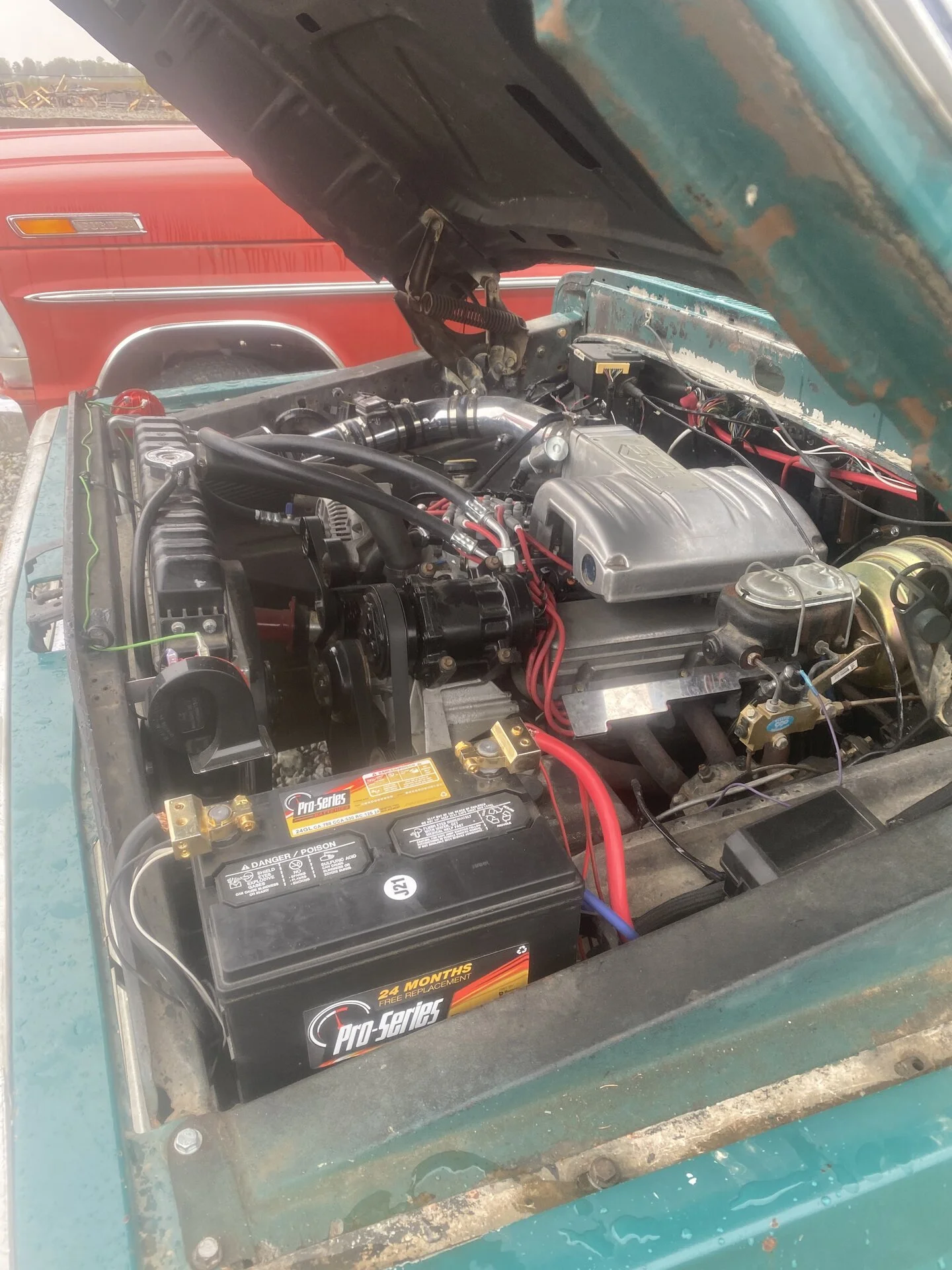

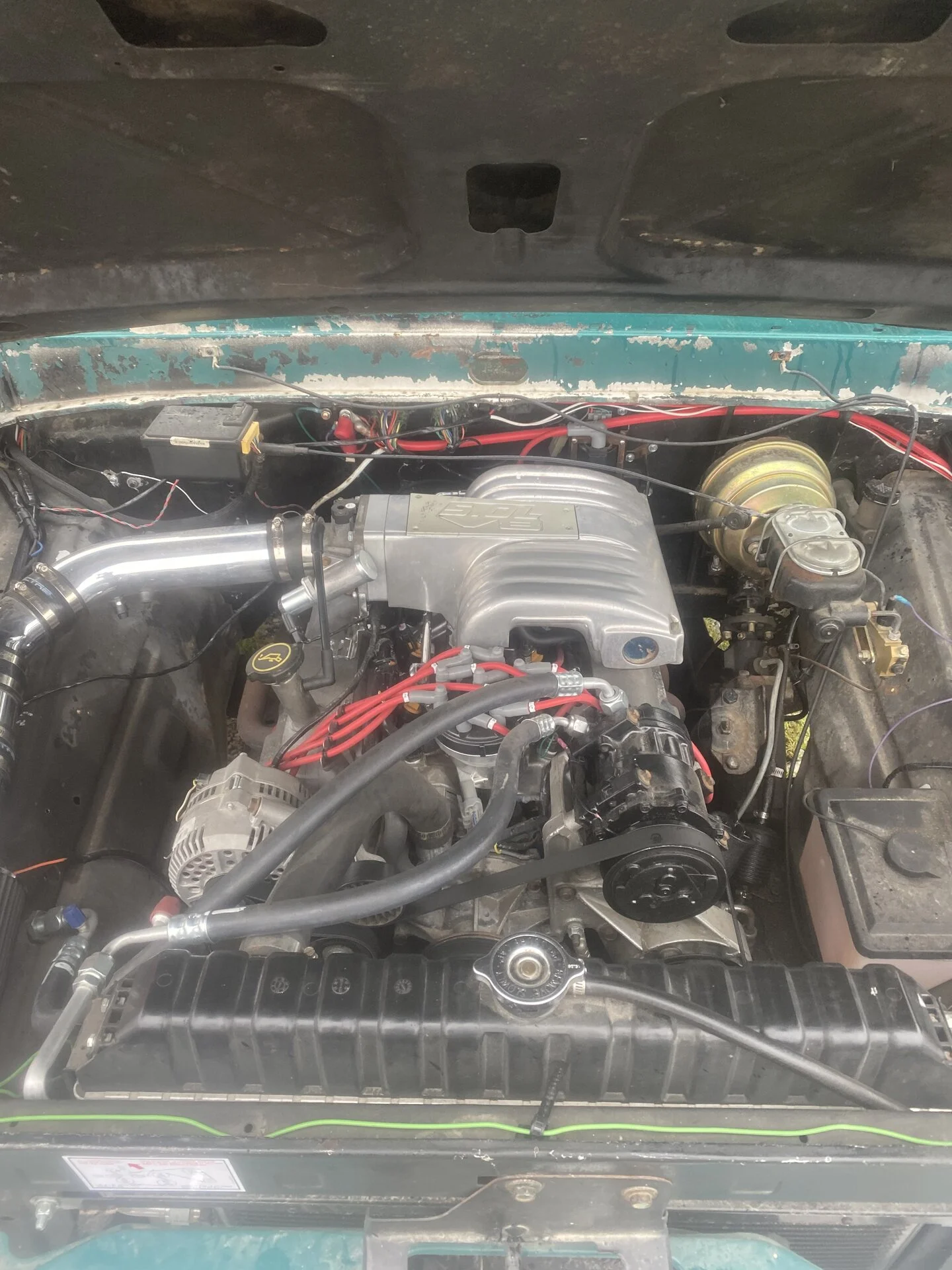

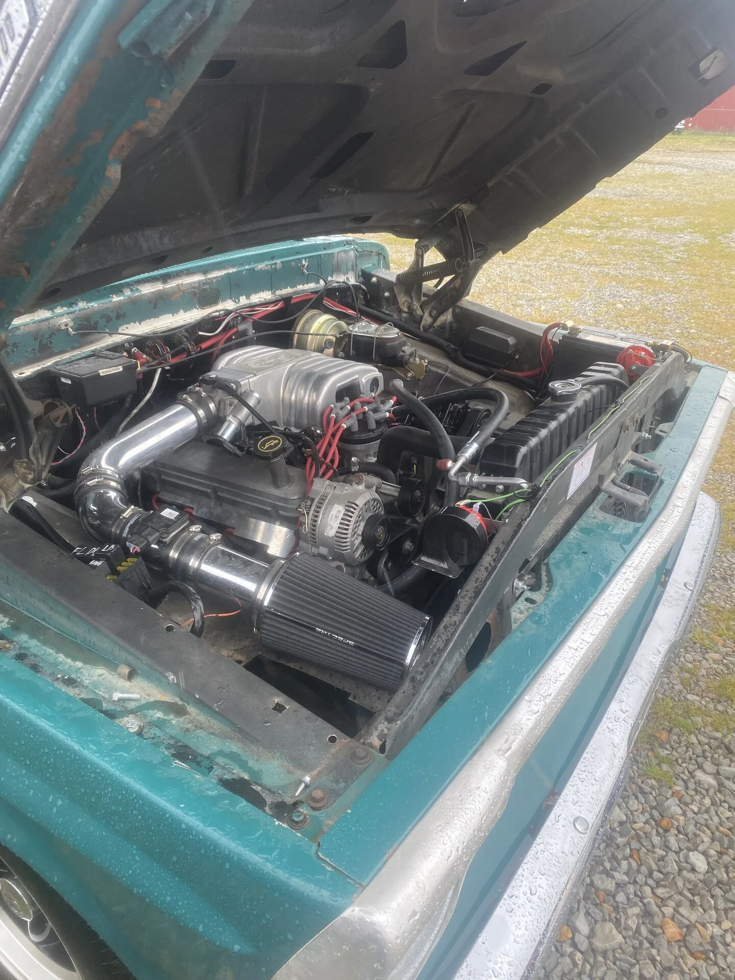

Nope they aren’t eBay injectors, but I’m not sure if they are any better. Rockauto. Oh well. If I get a chance between my daughters t ball then I will try to check that this weekend. I sure appreciate y’all. Here is those current pics I told you I would get. I have a box built that goes around the air filter and seals to the hood. I have it off right now cause it’s kind of in the way when working on it.
