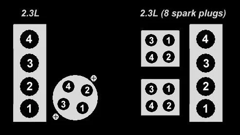

It really sounds like the timing is off. Backfiring out the intake and sounding like it wants to go is classic timing symptoms. This is an ignition problem in my opinion...
Double check that you have the firing order correct.
