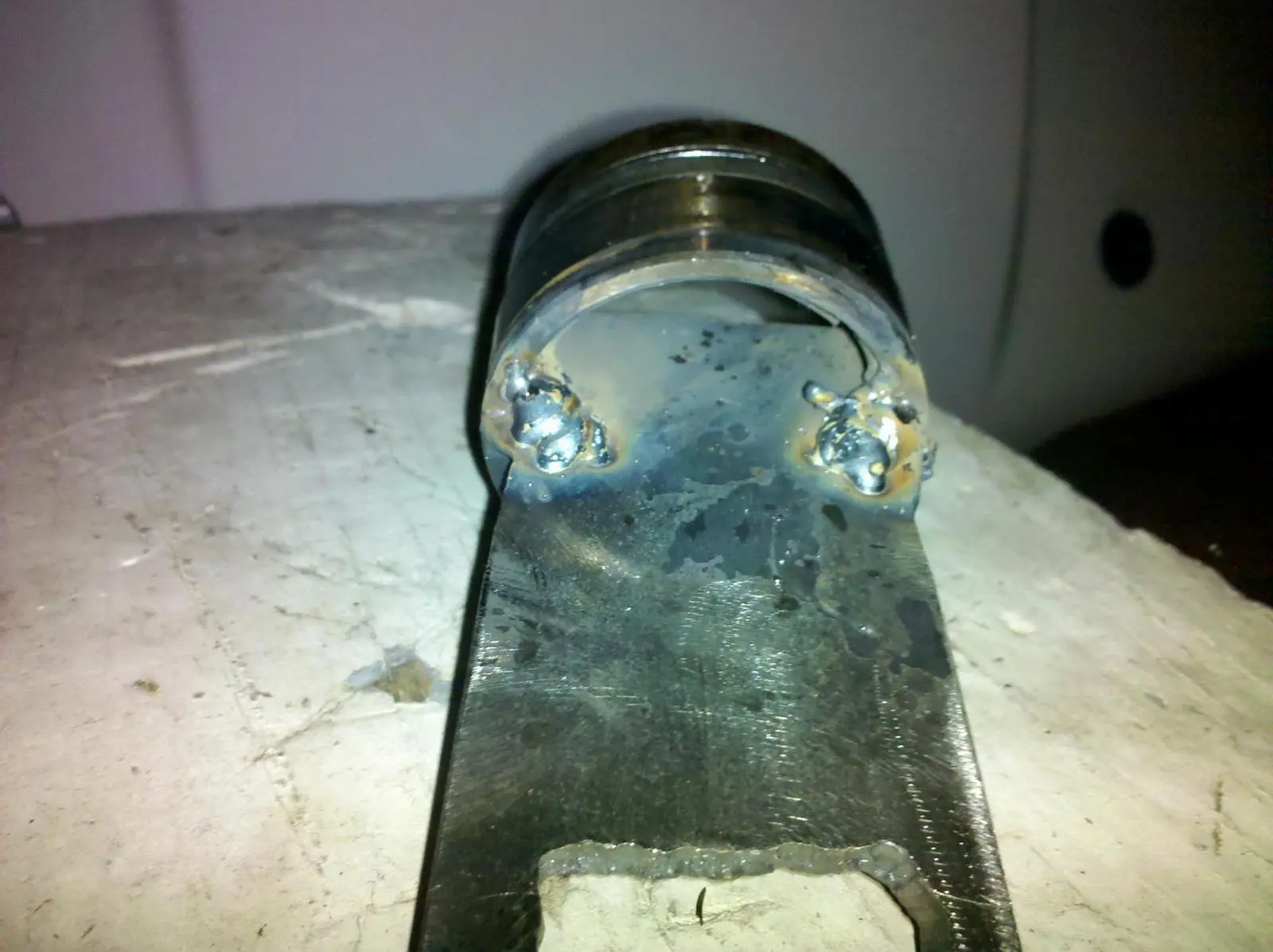

Man it was only a couple of months ago did I have the WORST time getting my passenger side axle bearing out. I heated it up as much as possible and it was still a pain in the rear to get it out with a slide hammer. I ended up fabbing up a little piece of metal and tac welding it to the axle bearing, used the slide hammer on the end piece and got that sucker out.

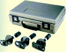

You're using these right?
