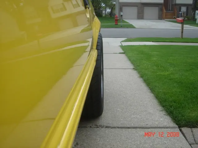

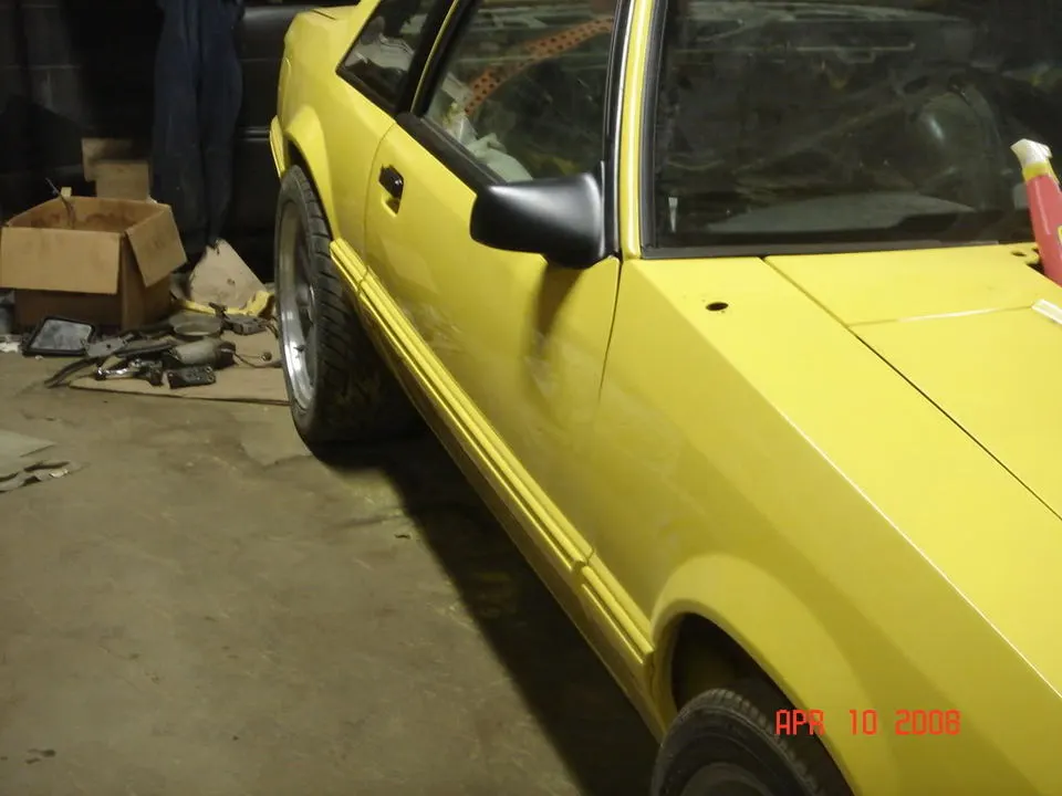

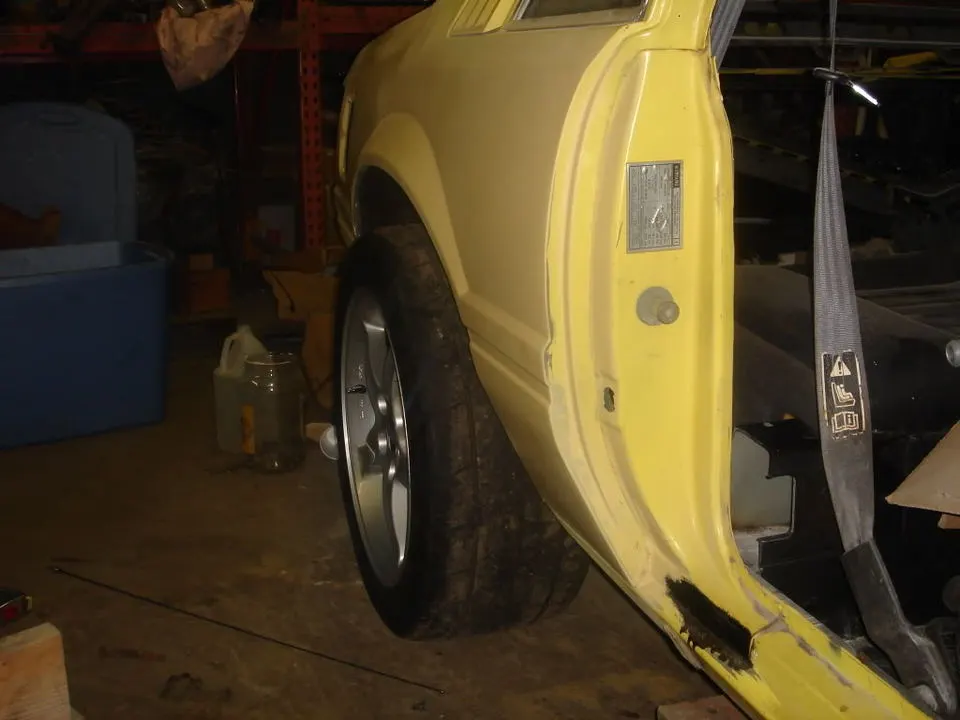

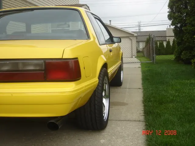

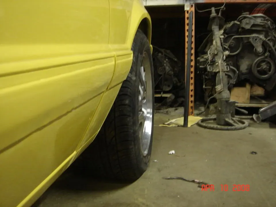

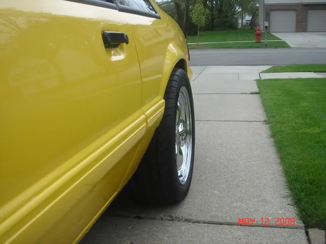

To the OP Ihave tried all the wheel combos...
....I put a 2001 axle in my fox body. 3 wheel options, here's a break down:
1.) 17X8 +30mm offset fit, do not stick out past the edge, but they look goofy because they sit outward to far, there is no meat under the car.
PIC:
2.) 17X8 +45mm offset (that is a 05+ Mustang wheel) They do not stick out, in fact, they sit inward 15mm from the 17X8 +30mm offset wheel, and look pretty good.
PIC: (Pay attention to the wheel in the pic, NOT the tire. That's a 235-55 Tire.)
3) 17X9 +45mm offset (05+ wheel again, from American Muslce.) They do not stick out, but they sit right at the edge, and the extra 21mm you get, is all under the car. You get more meat under the car. You will need to make sure you have enough room to clear this combo. I made bump stops on each frame rail that hit the axle tube 1" before the tire would have hit the quarter. I also had to ROLL THE FENDER LIPS!!
PIC:
A BIG NO-NO is a 17X9 with a +24mm offset. PIC:
Look where my straight edge sits.
