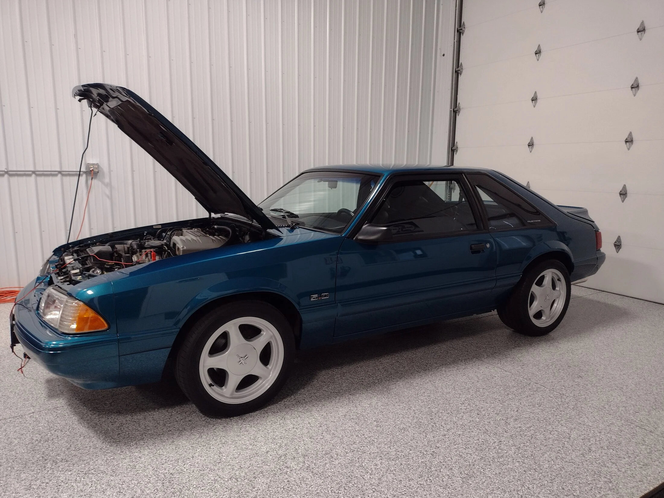

Hey everyone,
Looking for a little help here. I noticed the other day while braking and coming to a stop I could hear some rear noise. I initially thought loose lug nuts or bent axle.
So I rocked each rear wheel in and out while the car is on the ground and it's making a clunk noise. I can make this happen if pushing on the body of the car as well. Almost like the rear drums are making the sound.
Car is mostly original with 27,700 miles.
Any suggestions?

I'm honestly not sure if this is a new noise. I barely drive this car. The only reason that I heard it the other day is because I had the stereo volume way down.
I've only driven this car maybe 200-300 miles since I bought it a couple years ago. I did add 17" pony wheels a couple years ago.
