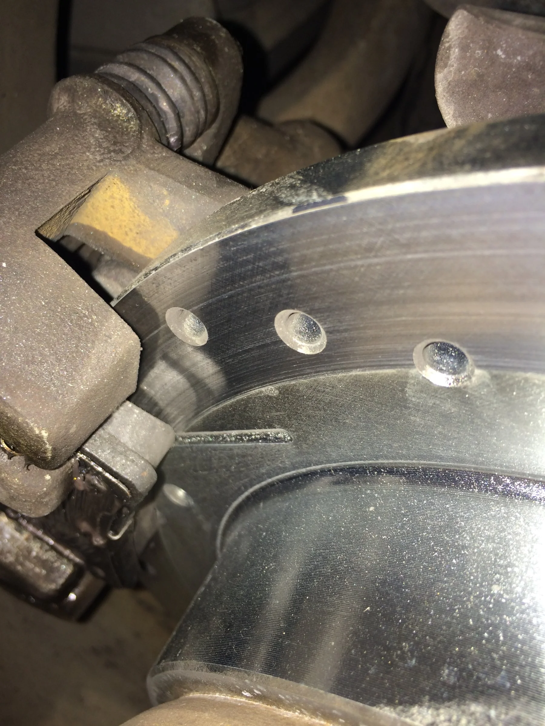

I already got rid of the old stuff but this is one it looks like. See how not all of the pad is making contact with the rotor? I checked alignment and tried fitting it another way but it only fits like this. Just doesnt seem right.

The rotor itself is clearly undersized or the caliper is mounted too high. My advice, measure the new rotors. Rears on a 2001 are 11.65" in diameter. If the rotors you have are that size then I'd question if the caliper is bolted in place properly. You said you tried moving it around... Did you look at whether you could move the caliper bracket behind the rotor?

Looks like someone swapped a Cobra rear disk brake setup onto your car at some point in the past. That is why the caliper is spaced so far from the rotor. The extra offset is due to the axle brackets which are installed after removing the axle shafts. You need to purchase a 94-04 Cobra rear rotor for that side in your pic to reach the full offset of the caliper.
Problem #2 is that is a GT rear caliper. It's physically different from the cobra caliper in that it has a thinner slot for the rotor, and lacks a support bridge. You'll also notice the different brackets have no difference in offset. You could use the cobra one on the gt brake system without issues. You just can't use the GT one on a cobra rotor because the cobra rotor is wider.

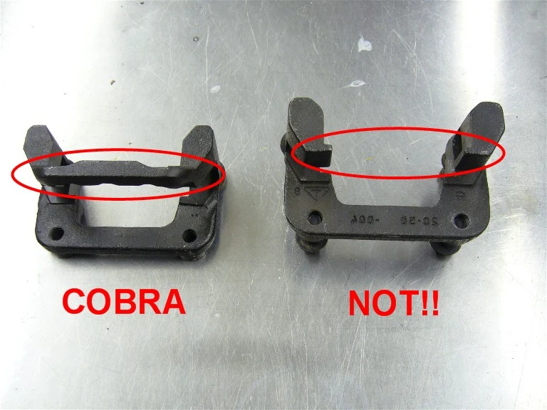

Notice here the bracket connects in the front on the Cobra. In order to run the cobra rotors, you need this bracket. Rockauto.com sells these.
A-1 Cardone 141042 $19.
Check the other side and see if you have the correct bracket there as well. It is possible to take a grinder and widen the slot, but with brakes, I wouldn't take the chance considering the right part is under $20

Holy Cow! Makes a lot of sense. I figured my car had a rear end crash or something just because everything looks different. Either the previous owner "Upgraded it" or a shop did. The driver side did have a larger rotor. It was 11+" compared to the passenger side, i had thought someone mistakenly placed a front rotor in the back. Thanks! I was losing my mind trying to figure out why it sat so high when everything looked stock.
