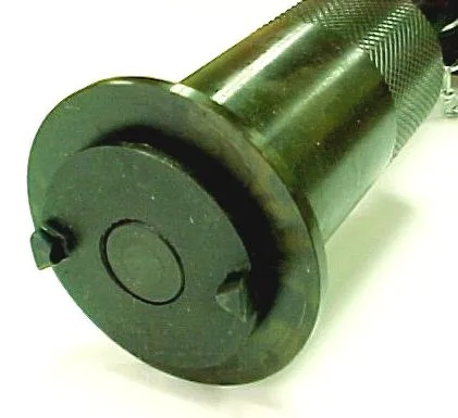

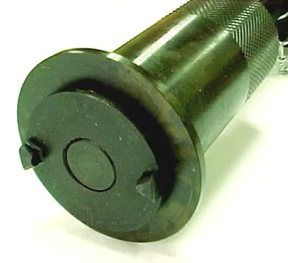

I'm not sure what tool you are using but if it is the little cube with the diffrent ends for every model, forget it.
You need the tool that you turn with a hand ratchet clockwise as you compress with the handle. They can be very hard at first. Try to forget about compressing it and just try to get it turning first (assuming your using the right tool).

Should be this tool

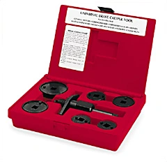

Well i finally got it to work. I found out the tool was using wasnt turning it was supposed to turn and push in but the tool was broken at the tip and just pushed like a c clamp. so i took it back got another one. And got them on fine. thanks

I had to bleed a small amount before it would compress as well. I wasted 2 or 3 hours fighting it with various shoddy tools before I broke down and got the kit from auto zone.
