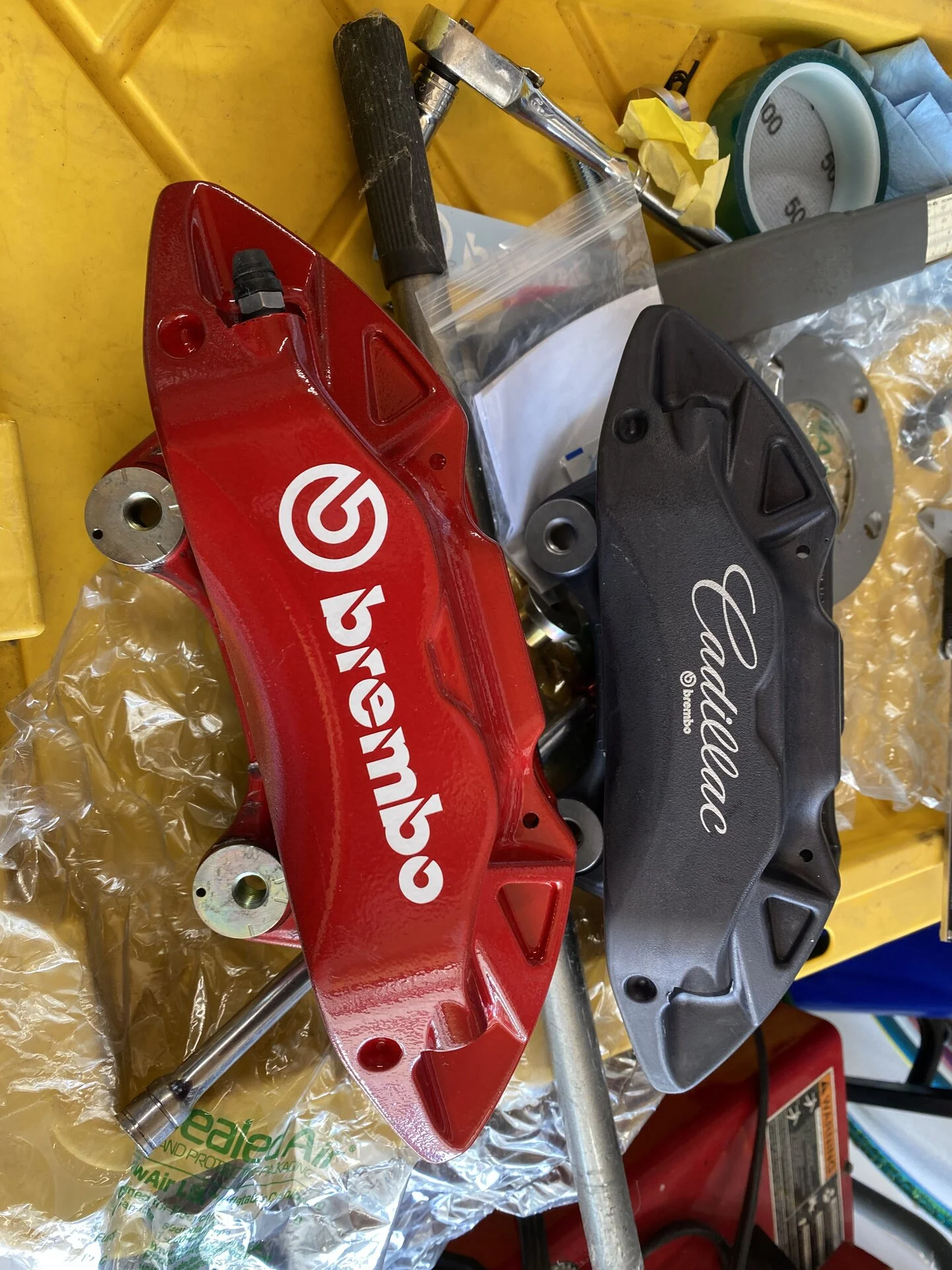

I am about to finish up the front brakes for the powder coating job. They were super simple to tear down when comparing to the rear calipers. Since the fronts are Brembo I went with a Ford Taurus rear calipers to maintain the 70/30 split.

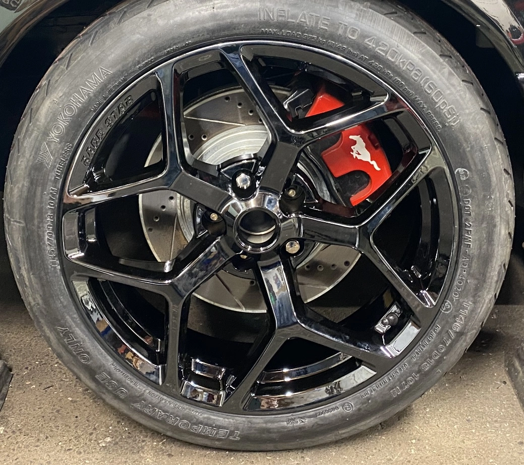

Before / After powder coat job:

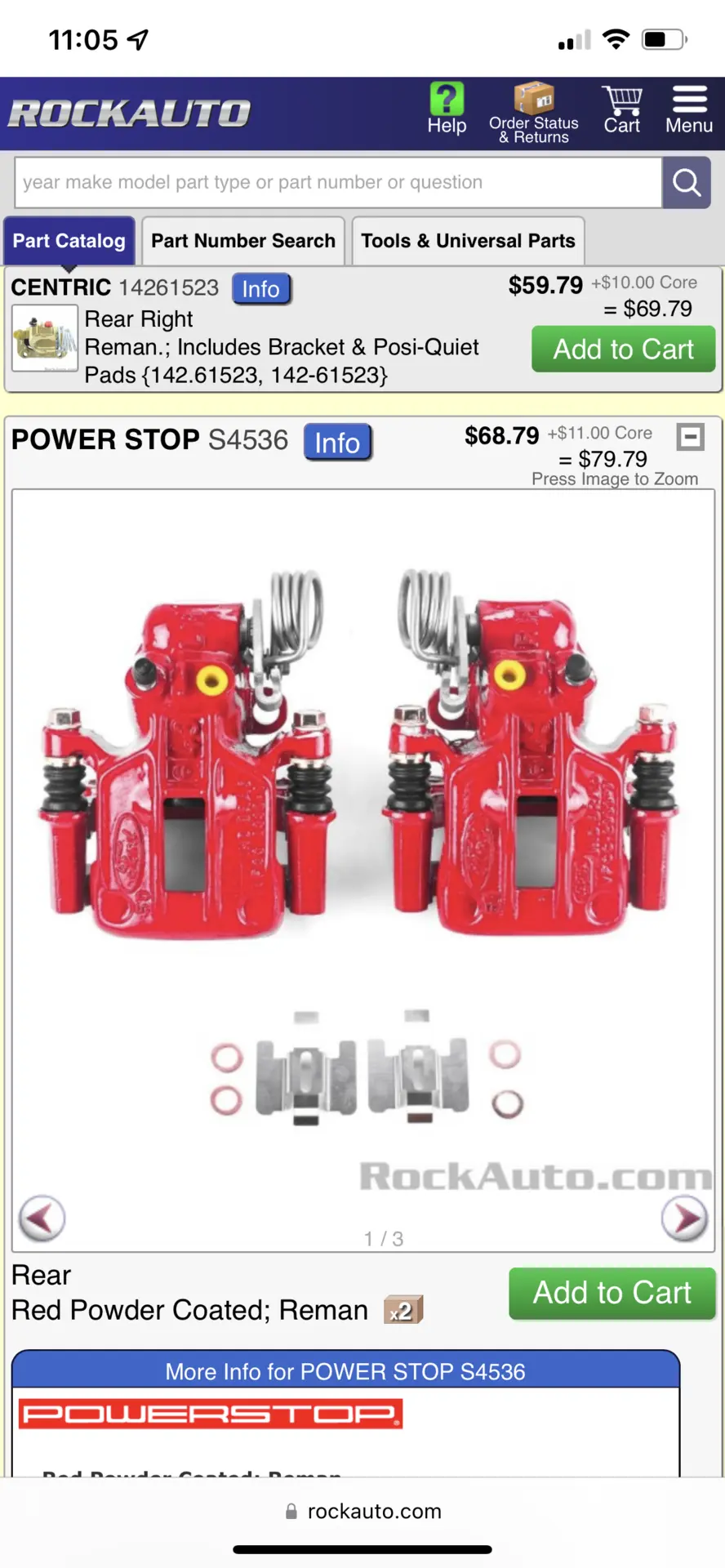

You can even buy the 38mm and 43mm rear calipers already powdercoated for $150 for the pair. DADA0531-B63B-4C1C-97BA-C87A14CB619D.png
Painting is fine. I did mine in the VHT caliper paint with a decal and clear and it’s held up. That’s how I did my front ATS brembos. I also did my current C6 calipers 4-5 years ago and they’ve held up great with paint. It’s all about the prep. My rear calipers are the above powdercoated ones.
