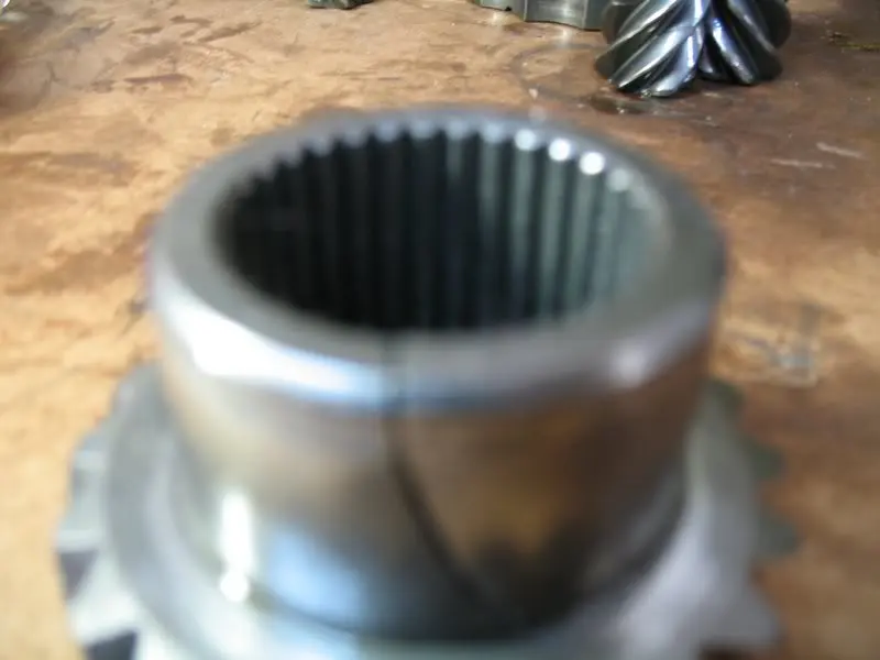

The True trac is a very nice LS. I had one for 2 years in the GT. Unfortunately my 31 spline unit was no match for my manual transmission and slicks at the dragstrip. After about 120 hard runs one of the cones that attach to the axle cracked. In its defense, my axles splines were twisted on both sides too so I know I was putting some serious power into it. I did find that the little screw gears also had some wear on them. No parts are available from Eaton to rebuild them so mine is garbage fodder (unless I can score another broken one.
I would certainly purchase another for street duty as it worked well in that application.
