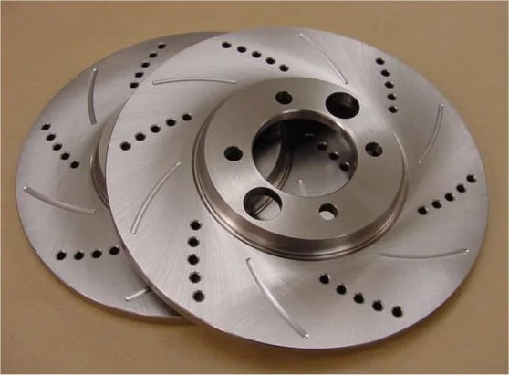

Sorry, but the rear rotor in that picture is a drilled and slotted solid rotor, not a VENTED rotor.
There seems to be a misconception of what a vented rotor is.
this is a vented disc rotor:
This is a cross-drilled, slotted, solid (non-vented) rotor like the Eradispeed kit uses:
The solid (non-vented) rotors are only 3/8" - 1/2" thick, whereas a true vented rotor will be 3/4" - 1-1/4" thick (depending on application).
