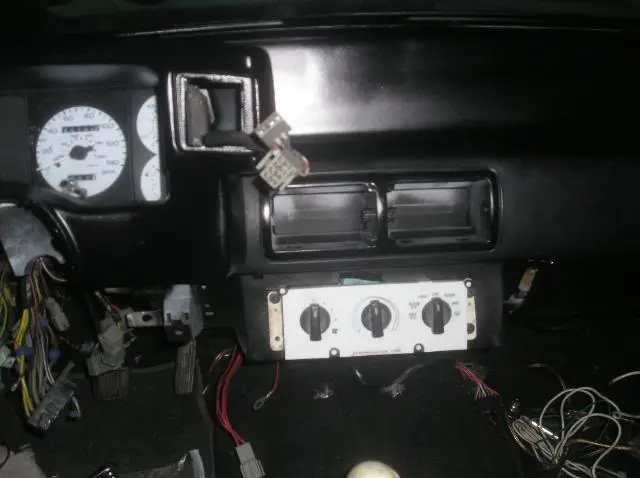

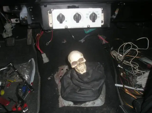

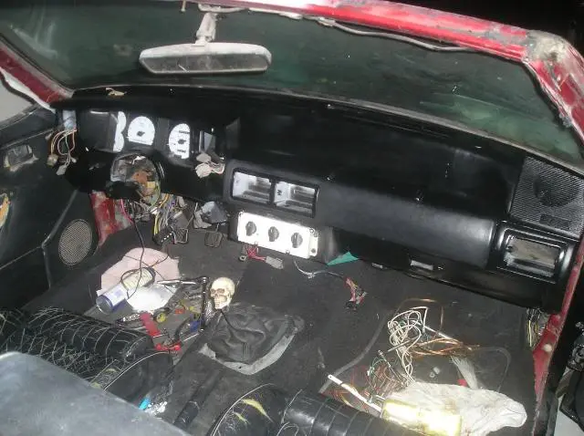

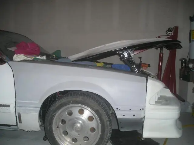

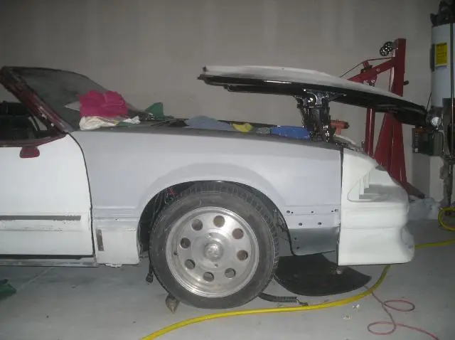

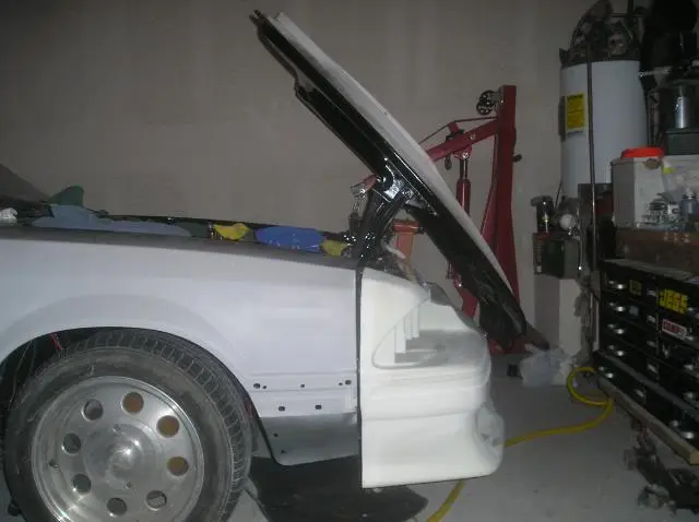

OK. Here are some pictures that I took of my dash and how the hood opens up. I also need to know were that red wire goes to. Its right under the radio and it looks like it would go to ground but the color is red. so not really sure:shrug: My dash is in and just need to put my steering wheel on and figure out what wires that I need to connect back.Well I'll post some more pictures later, tonight or tomorow.

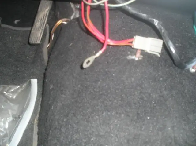

Ok heres the wire that I'm not sure where it goes, do you know were?

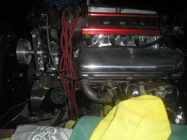

Heres a picture of my engine with the stock valve cover. I started to polish them. Put them on the buffer for about ten seconds(NOT BAD).. I sold my other ones to buy some new ones, but not sure if my stocks will clear my roller rockers. I' started to grind the inside so we will see if they fit.If they do I guess I will keep those for now.

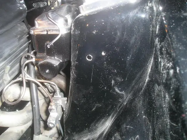

Soon as I finish up my wiring I can start the outside of the car to get it ready for paint.

It's a ground wire that attaches to the lower metal frame of the dash. I might be mistaken but I think there a two ground wires that connect under the dash in the middle. Keep up the good work.
Thanks a lot guys . I tought it was but wasn't sure. Just wanted to be sure I don't want to burn my car down after all that work.....:D. Well i'm off this weekend so I might be working on the car. haven't had time... Thanks again everyone...

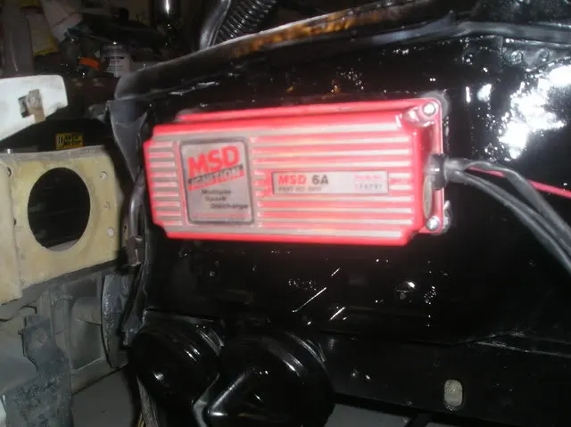

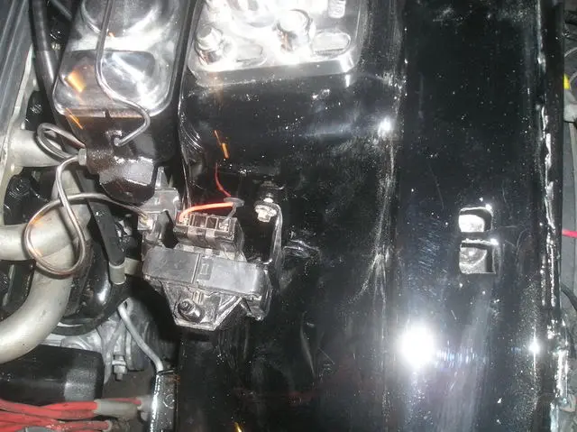

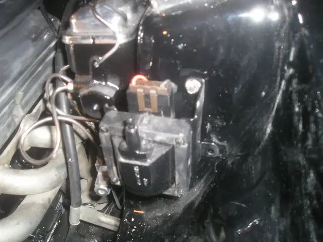

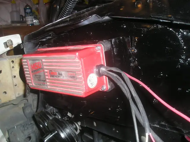

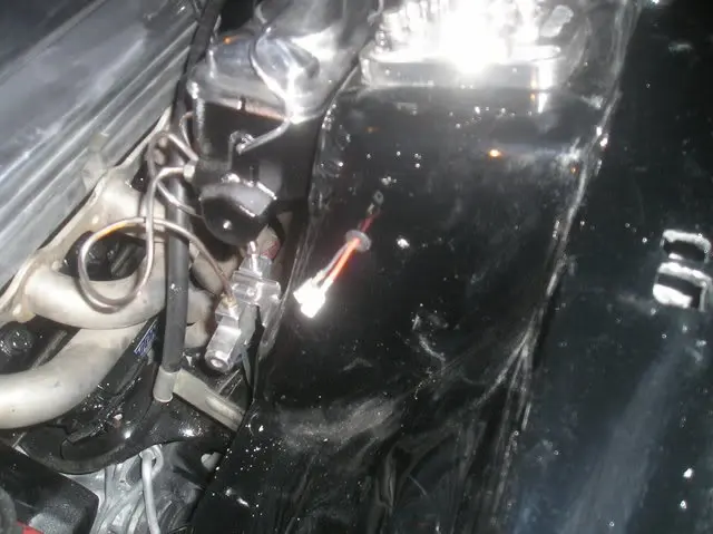

Well here are some of the pictures of my msd box, I welded a sheet of metal to install the msd mounts and the box.. I also made a hole behind the coil to install the wires that come out I added a grommet to make i come out from behind.. I put the stock coil to take picture nbut will be installing my msd coil.The pictures look very dusty so doesn't look that great...

When you first started this thread I wasn't too sure about this car , but over the months we've seen your work and its really good, you put a lot of thought into it. I'm excited to see the pics when its finished, it should surely make FOTM someday. :nice:

nice work on the msd!
.. Thanks. I was debating in putting it inside the bay or outside but I had more people telling me to put it outside since I did all that work in the bay.Well at the moment I haven't really advanced on my project.I finished up my wiring and had my brake lines done, but I received My Line loc from B&M and now I'm strugling with the damn fittings not sure which ones to get.After thats done I will be running my vacum lines that I forgot to run...LOL
