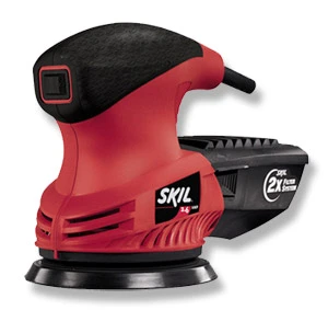

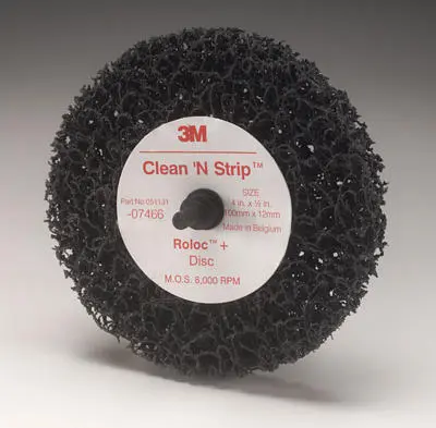

Well the body work started out of boredom. I live in an apt and can't do too much outside, besides it's cold. I removed the trunk lid, hood and fender (one at a time) and brought them in the house.First I took off all the hardware and cleaned and painted it. I took a scotch pad attachment that fits in the drill and got all the rust off. I have a electric orbital sander that uses "loop and hook" pads and used an 80 grit. What paint that is left on the decks is peeling so I took it down to almost bare metal. Used putty or bondo when needed. I wet sanded it with 600 grit to get everything smooth. I washed it with soap and water, then wiped it with mineral spirits/paint thinner. The underside of the hood and trunk lid I sprayed with splatter paint from Auto Zone. The primer is rattle can also (cringe) I sprayed it on pretty thick and when I was done I wet sanded again to remove the over spray, using the 600 grit again. I plan in moving in the next few months and I'll get the air compressor going and finish. I've never painted a car before but this is a hobby/project so I am going to give it a whirl. I do plan on resanding the primed area and shooting a primer over the whole car. When I had the fender off the apt people threatened to tow the car off. I understand where they are coming from. If you have any questions please ask
vince
Here's the stuff I used, You can get all at your local Wal mart. I hope the pics make it. I've never tried to put a pic in.

I went and bought the 3m disk, I'm gonna give this bodywork thing a try Sun.
