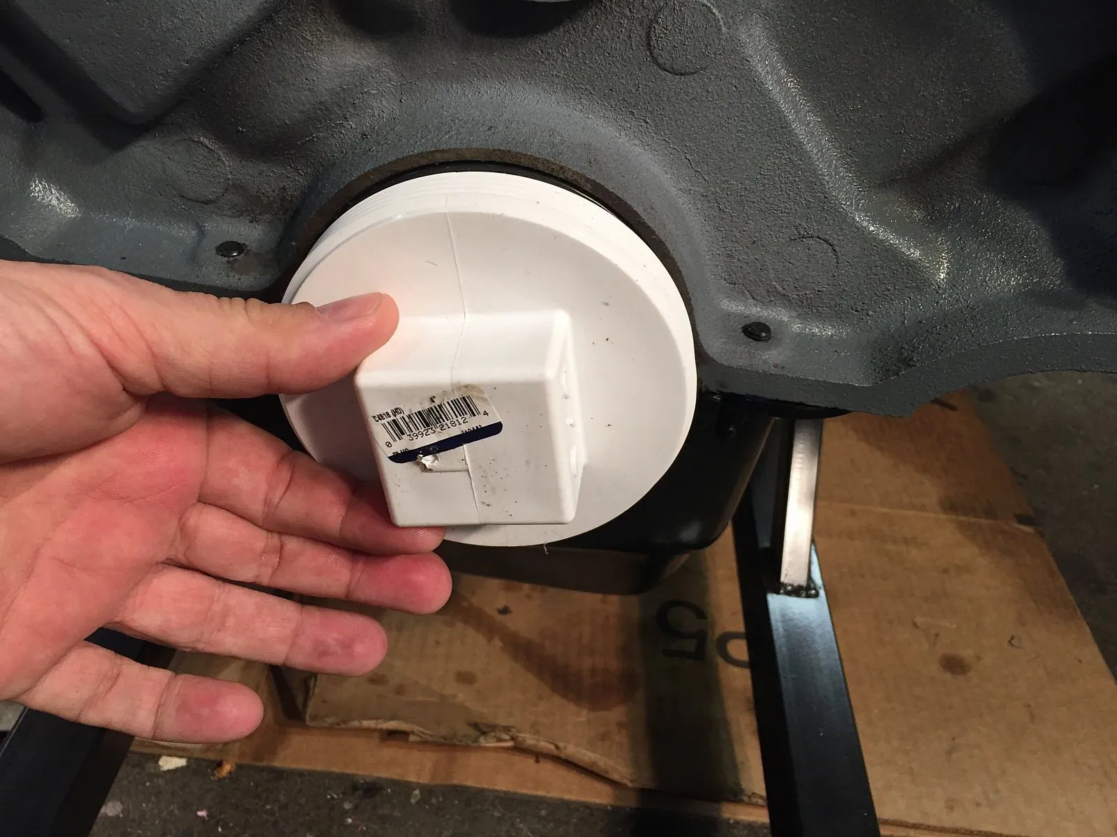

So I just ordered the Ford Racing rear main seal, crankshaft sleeve, & the loctite 518 (already have the thread sealer) so we'll see what happens. I'll probably go to home depot and get a 4" pvc cap like someone in this thread suggested and give that a shot. I appreciate everyone's advice. I hope this solves the problem.
There's a small price to pay for all this help.
Since this is a very informative thread to help everyone stop their rear main leaks, how about you come back in here when done and give us results? Tell us how you did with the PVC install method as well.
