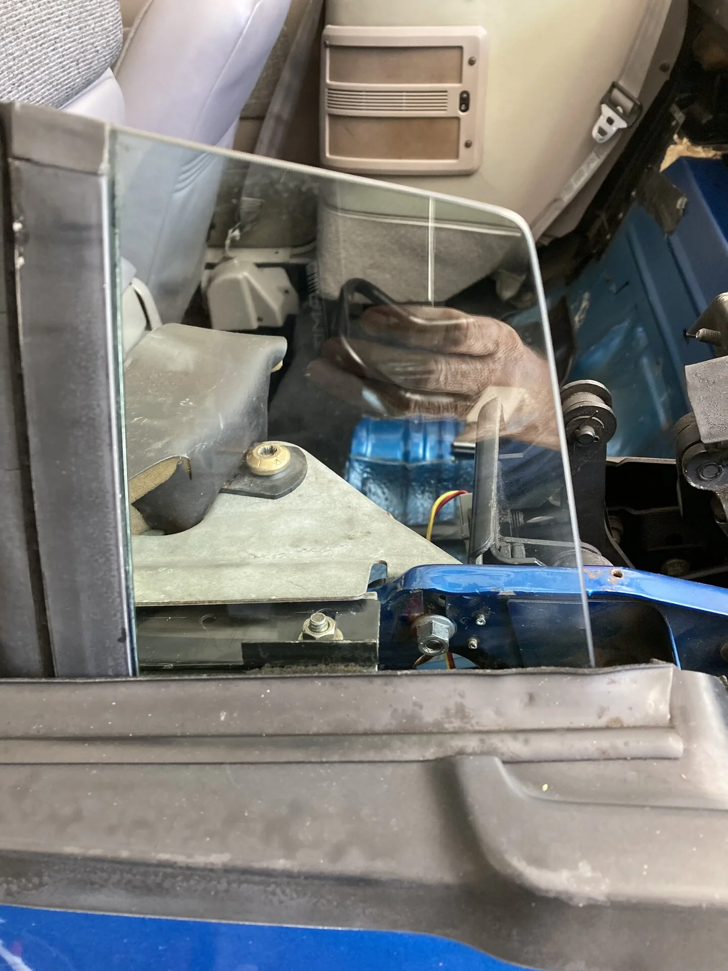

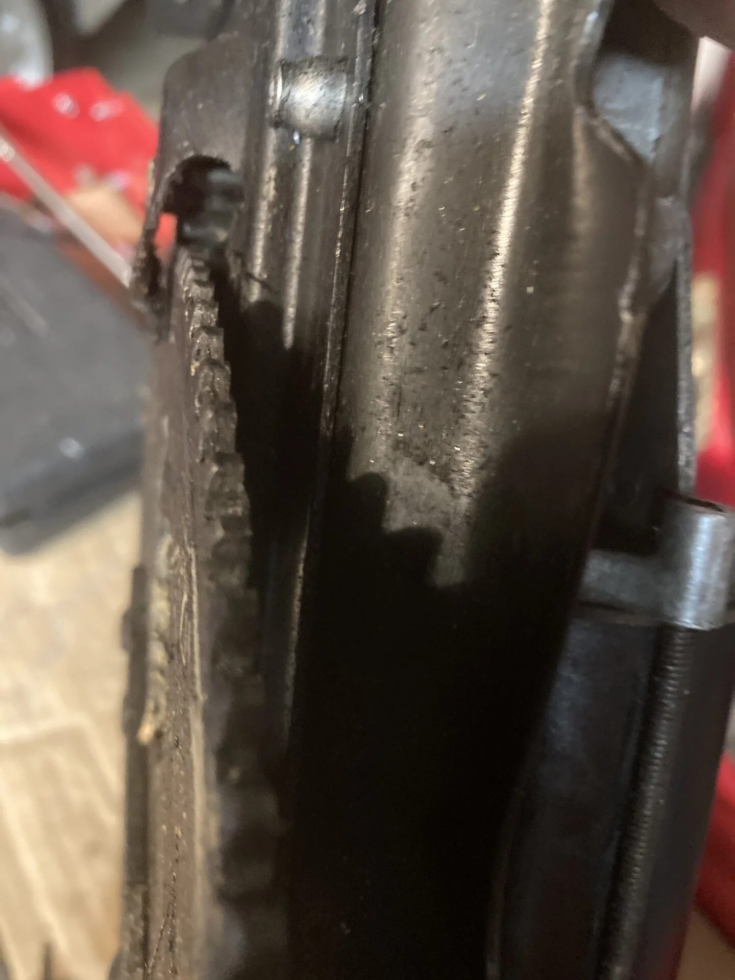

Pics please

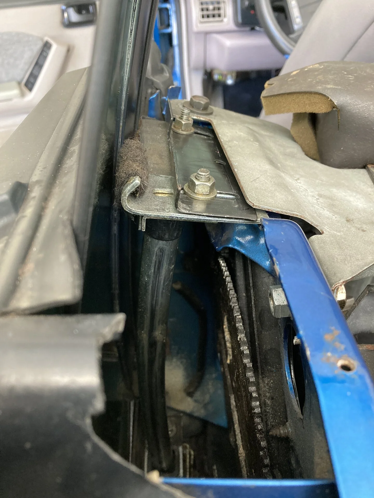

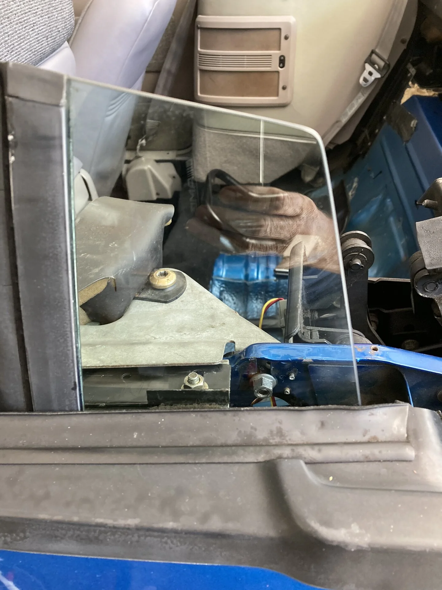

The first pic is how high the window will raise before it skips….if I lower it a little or just pull on it.up it comes. Middle pic window is up and next pic down. any ideas?

If the gear teeth do not line up in some spot the rivet holding the regulator together is loose
The regulator should be replaced
I have fixed a few by drilling and tapping the smashed side of the rivet for a small screw

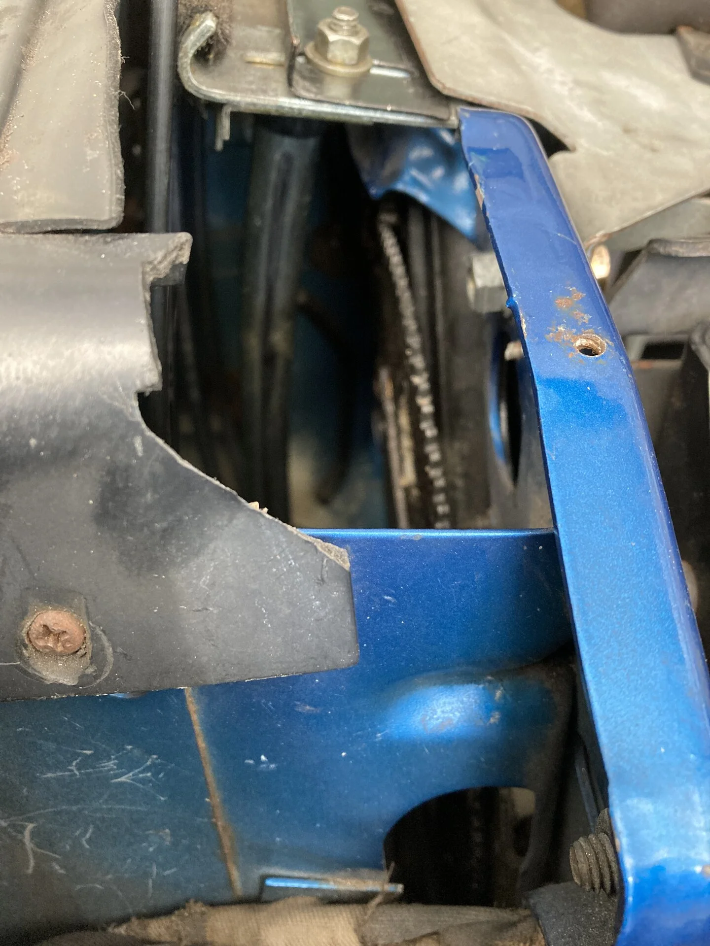

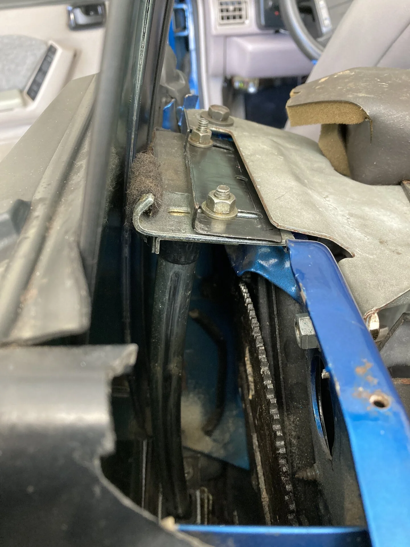

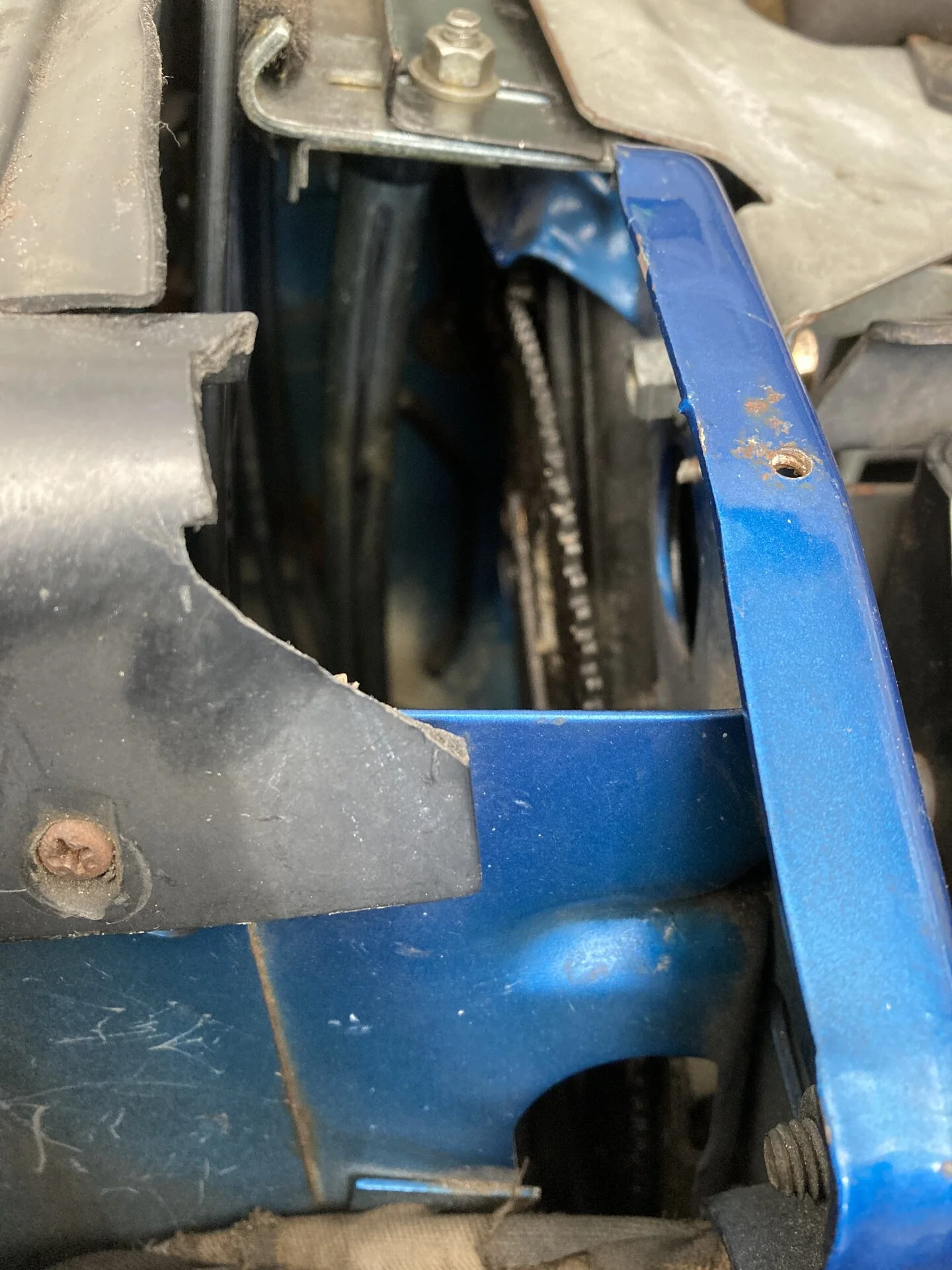

Here’s some pics…that’s how high the window goes up before it skips, if I lightly push a screwdriver against the regulator the window goes up fine, no issues..

I can't tell from those pics.

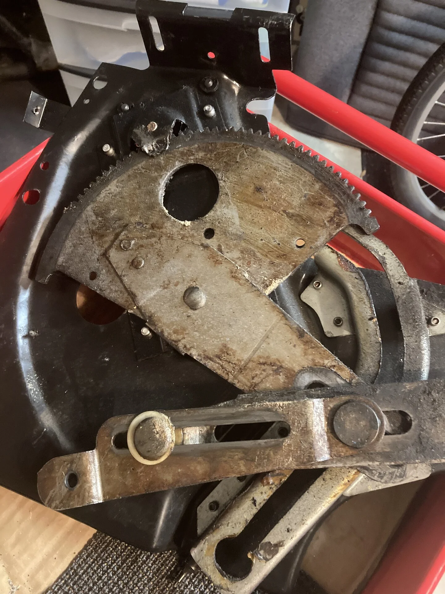

Here are some from today, I took the whole assembly off and in these pics if you can see motor teeth barely mesh with regulator, if I push the regulator towards the motor teeth..all good room to spare and when I plug it in , the motor/ regulator everything works fine. In the other pic the assembly has some play in it and not sure if it can be taken apart and pressed back together and I don’t see where I can get a replacement for the quarter windows?

Dollars to donuts one of the regulator arms or bracket is just slightly bent. Wouldn't take much to make it misalign. Since you have it out, clean it really well and closely check those arms, gear and mounting bracket for straightness. A slight tweak may remedy the situation. Heat may be required. You can pick up used ones on Ebay, usually from junkyard sellers who will guarantee straightness, at least. A quick check didn't reveal any drivers side units but there were plenty of pass side pieces. They come up all the time. May want to contact some of those sellers to let them know what you're looking for. I bought one off Ebay, not long ago for my '93 and it worked perfectly.
Appreciate the help, didn’t think about eBay for one.. when I press a little on the arms there is some play so if i could get that a bit closer it would be fine. Going to check a couple shops to see if that’s possible and not more $ then a junkyard find.. thanks again.
