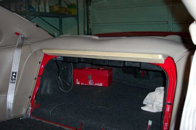

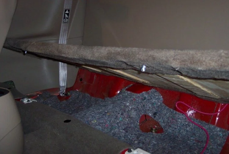

With a little custom work it looks stock. I bought carpet and vinyl from a local automotive intererior shop that matches that stock pieces. I also used a 1x4 to space the back out so that it fits flush with the head rest. The back is hinged so it can still flip down, and the bottom is also hinged so stuff can be stored under it.

No, there is no nitrous, that is just a tool box :( The wires hanging there go to my 15" subwoofer and amp.

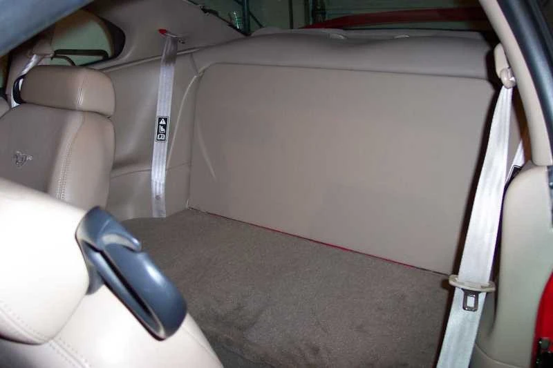

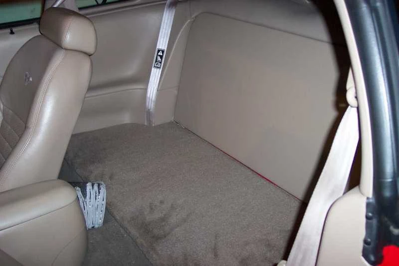

I do not have pics like you are asking for. Take my word for it, it looks stock.
Once you put the seats back they are far enough back (atleast for me since I am 6' tall) that the carpeted section blends right into the car. Since the vinyl on the back is the exact same color as the interior it blends right in. It all looks factory.
Due to the minimal space that there is behind the seat you really cannot extend the bottom surface out any more, it would hit the seat. It is just easier to stop where the seat stops. With a little engineering you can make the bottom fold up while it also can be locked down. No one will even know it opens. I keep my tool box and other misc. stuff in there. It keeps my car nice and clean, and nothing slides around.
