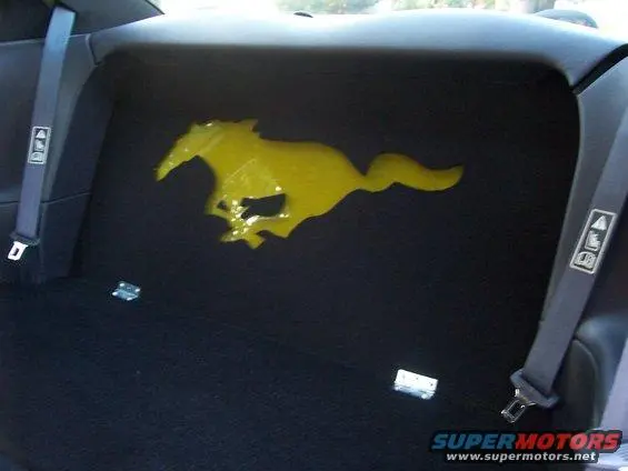

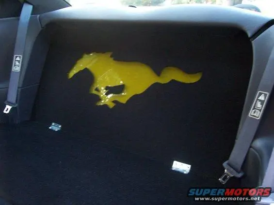

Here's mine.

you can remove the seatbelts too, heres mine

Here's mine.

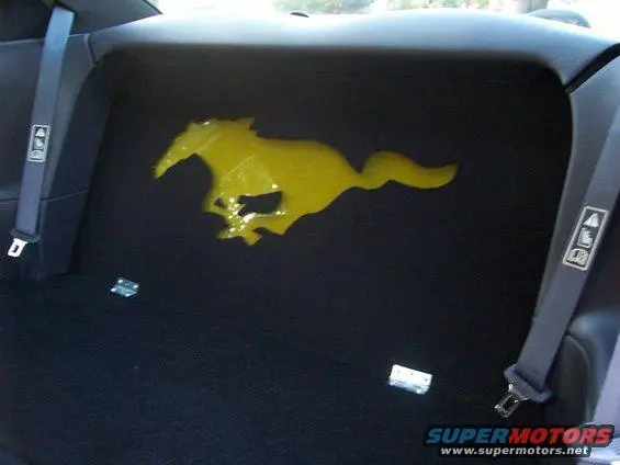

I made my own rear seat delete kit last month. I decided to take out the seat belts too. I have since put some nice black plastic pieces to fill the holes the belts came through on the roof.
Is the bottom of your RSD padded it looks pretty tall? What did you use to fill the seat belt holes?

bottom is padded, but has space underneath
Hey Jeff. I ran a 2x4 side to side across the car. I wanted the 5/8" plywood bottom to be the same level as the trunk. The back is easily removeable from the trunk (two bolts by hand) and can support hundreds of LBS on seat or back.
As for the seatbelt holes, I used 1/8" ABS plastic. You can pick up sheet ABS at Tap Plastics. I used a torch to heat up the plastic and molded it from the back side of the panel and used silicone to glue. It came out very clean, and looks great. I went one further and actually removed the entire seatbelt from car and avoided some potential rattling around of metal parts in trunk :D
