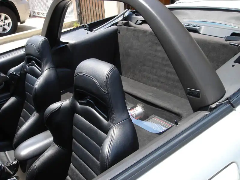

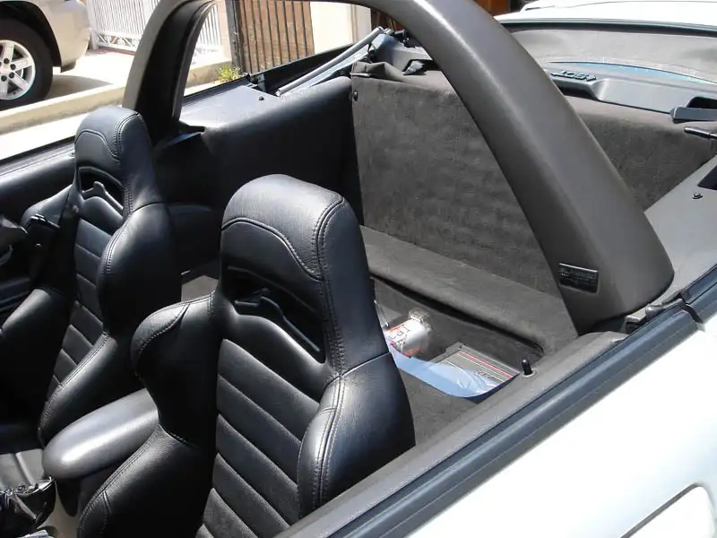

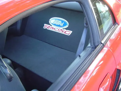

I used 3/4 foam board.....you'll find it at home depot, it comes in sheets like plywood..... It's VERY light, VERY easy to work with/shape, and does a good job of keeping any sound from the trunk out.
I used felt to upholster it, but you could just as easily use tweed or vinyl....

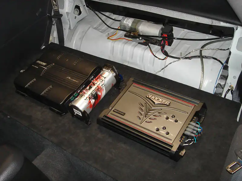

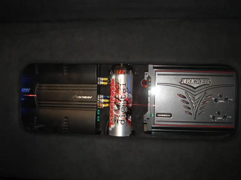

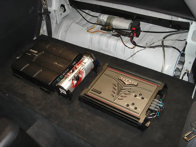

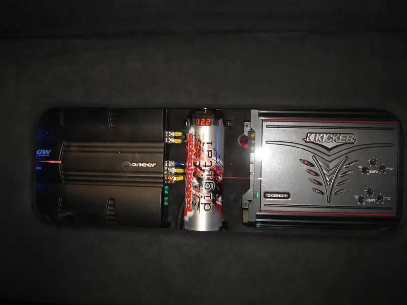

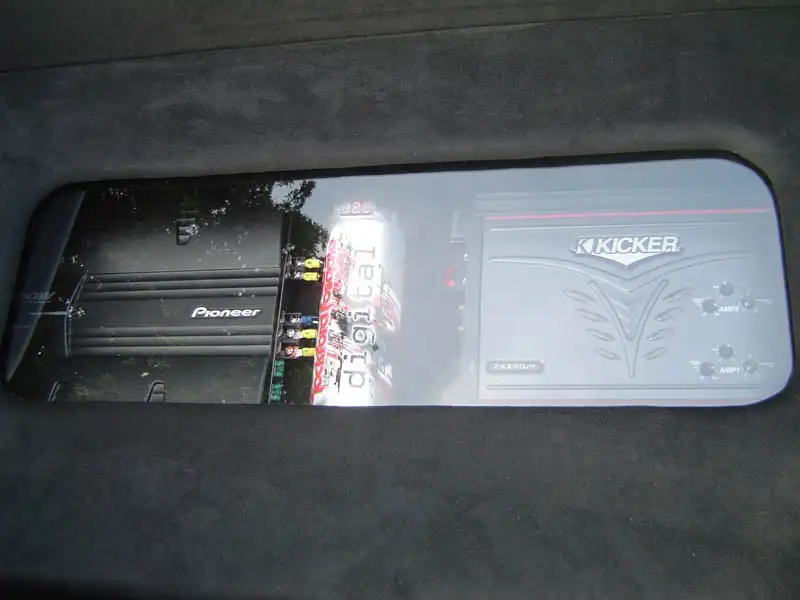

Damn that looks like a pretty nice setup Seraphitia102.

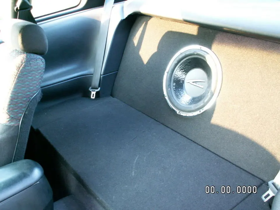

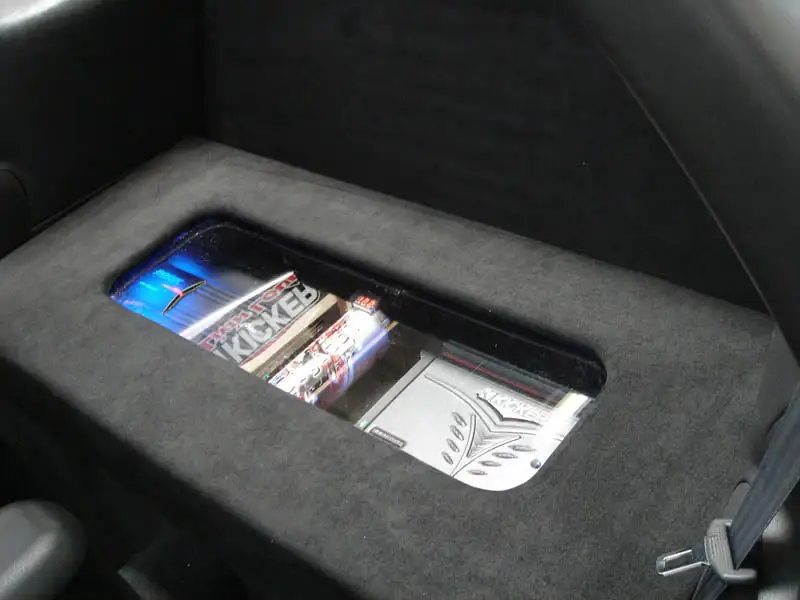

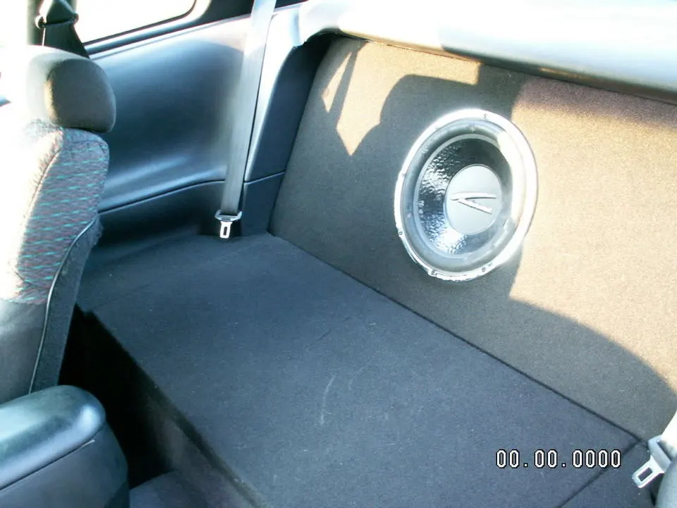

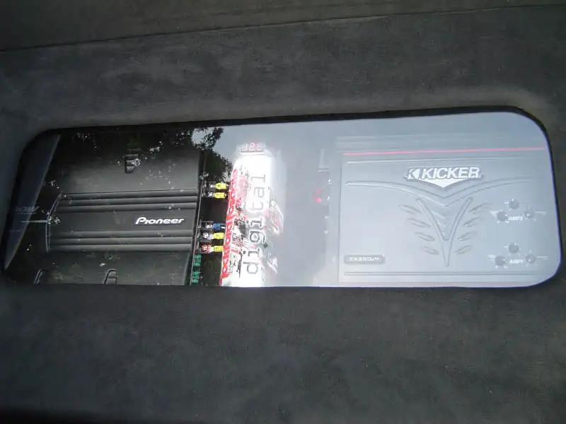

thanks! there's 2 reasons why my rear seat delete is like that. the first is that I can see my amps and capacitor because it looks nice, the second is that no one can sit back there anymore (or even try) to further lower my car and have me scrape on dips and speed bumps.
