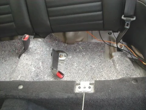

feel under the front lip of each bucket - right in the center of each side of the seat you'll feel a hard piece of plastic - those are your two latches.
Using flat blade screwdriver, push on the front of the latch (push gently towards the rear of the vehicle - it only pushes about 1/8-1/4 inch. pop up that side of the seat and repeat for the other side...
Once the 2 latches are released, just lift the seat up from the front and then pull it out to remove it.
Here's a picture.
