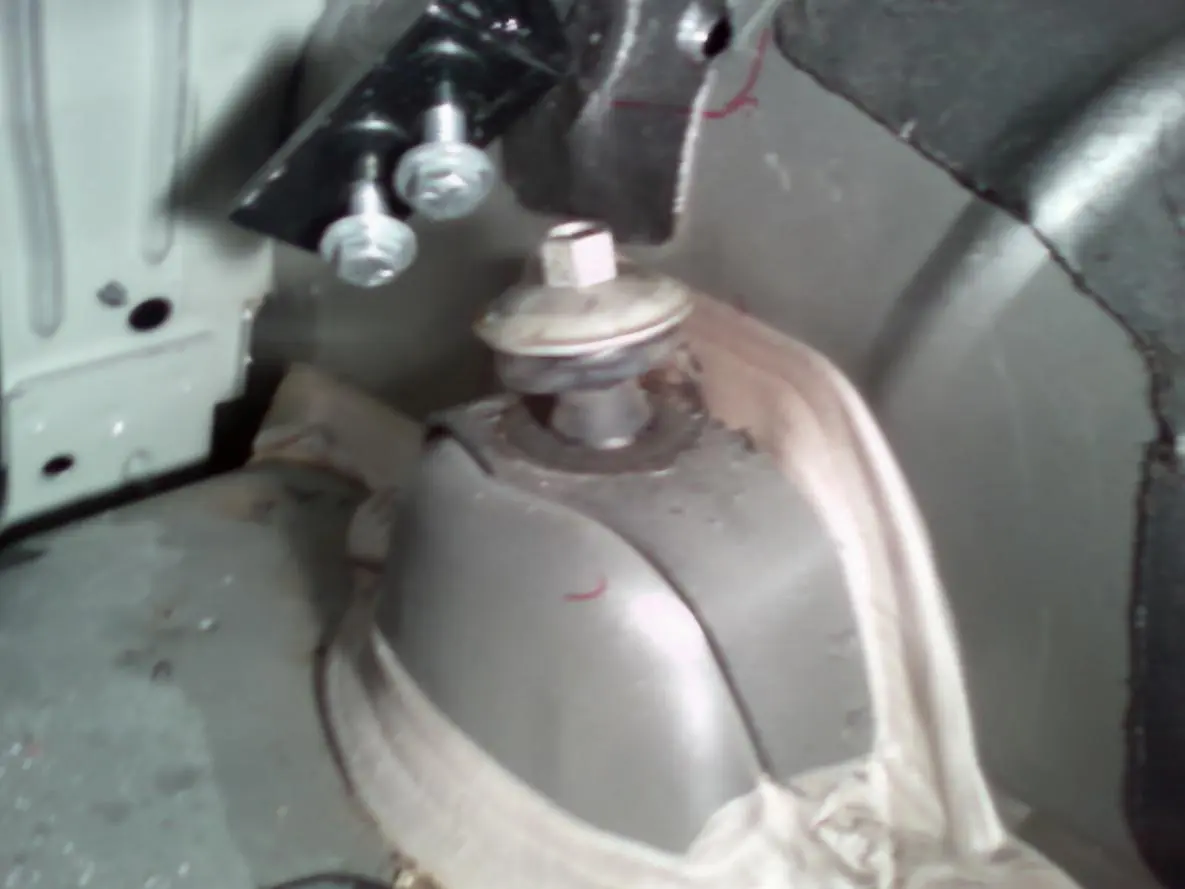

I must be retarded, that's all I can think.
I just installed new c/c plates, lowering springs, UCA, LCA, and new struts. Everything went fine until I lowered the jacks and went to tighten the top rear strut bolts (last step of this whole process). For some reason the top strut bolts stop tightening about an inch short and just spin. I've used an impact and it's not threaded enough to grab ahold of the top of the strut. I even took a grinder and cut a slit in the top to hold it with a screwdriver (prolly not the best idea, but I'm getting p***ed) and tried tightening it with a wrench with no luck.
Anyone have any ideas?

Pic.....
Here's a pic of the top of one of the struts.

Can't tell much by the pic.... You might have to get a diff impact that has more torque... No reason it should go on pending the threads go down far enough and they are all clean.

Pull off the top nut and take another picture. Looks like you have something else on the shaft that shouldn't be there. And you're not supposed to torque them down super tight. I think the settings are 17 ft lbs. Someone correct me.

take a picture from underneath also

Are you sure you even have the right shocks?

put the upper bushing through the lower bushing BEFORE you try and install the shock...that angled part of the upper bushing should be below the body

That's what I'm wondering...and for the record, we call these rear dampers "shocks", not "struts". I hope you put the CC Plates on the front...along with the "struts".
What he said. I thought it looked strange.

Yeah, struts up front, shocks and quad shocks in the back.

ya i dont know, are you using all the new hardware that came with it? cause that nit looks like the factory stuff
