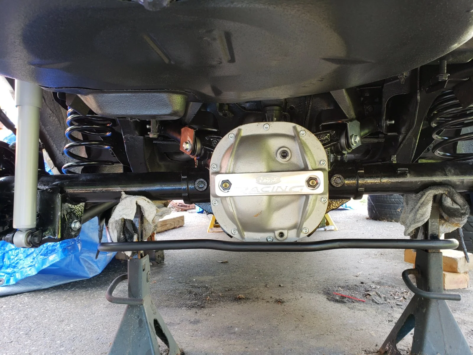

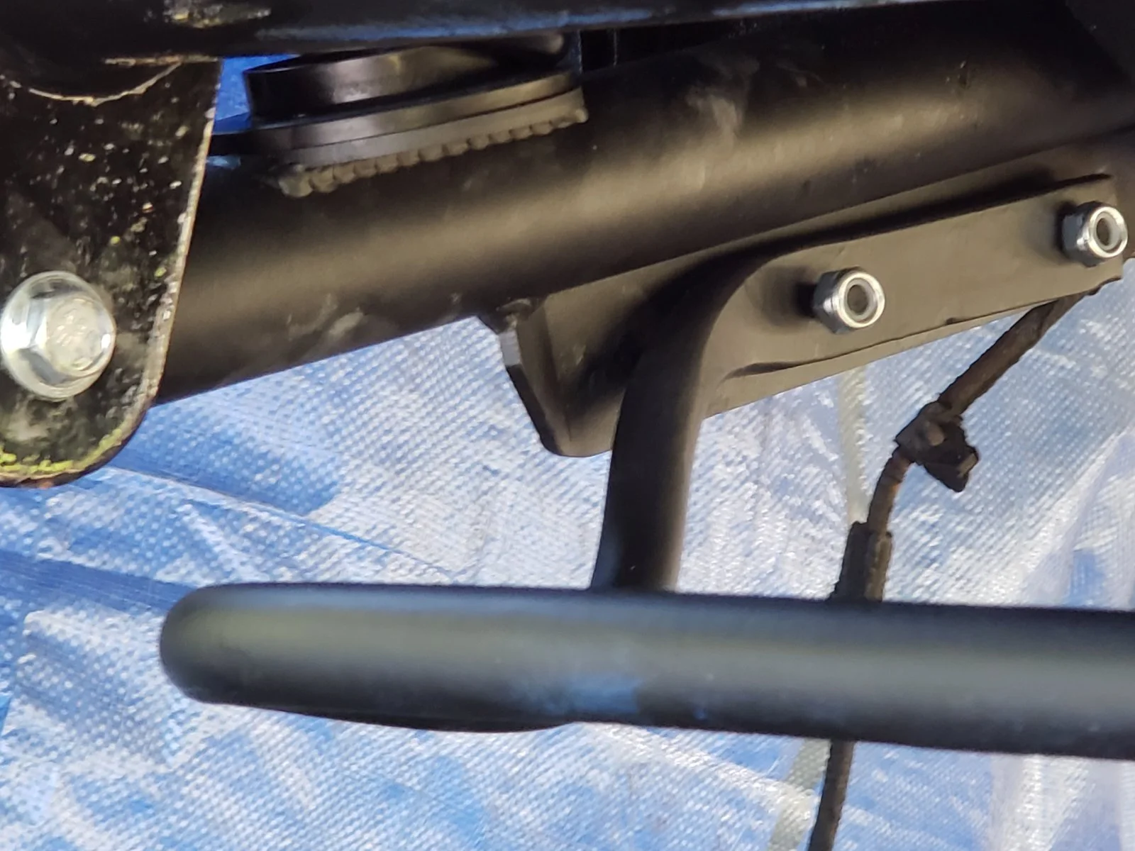

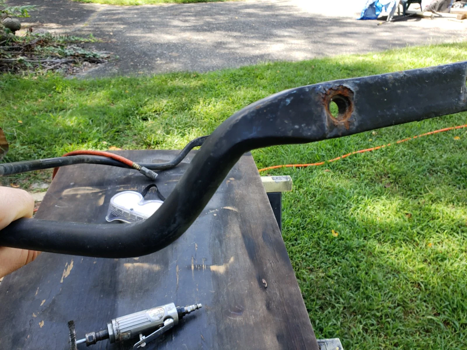

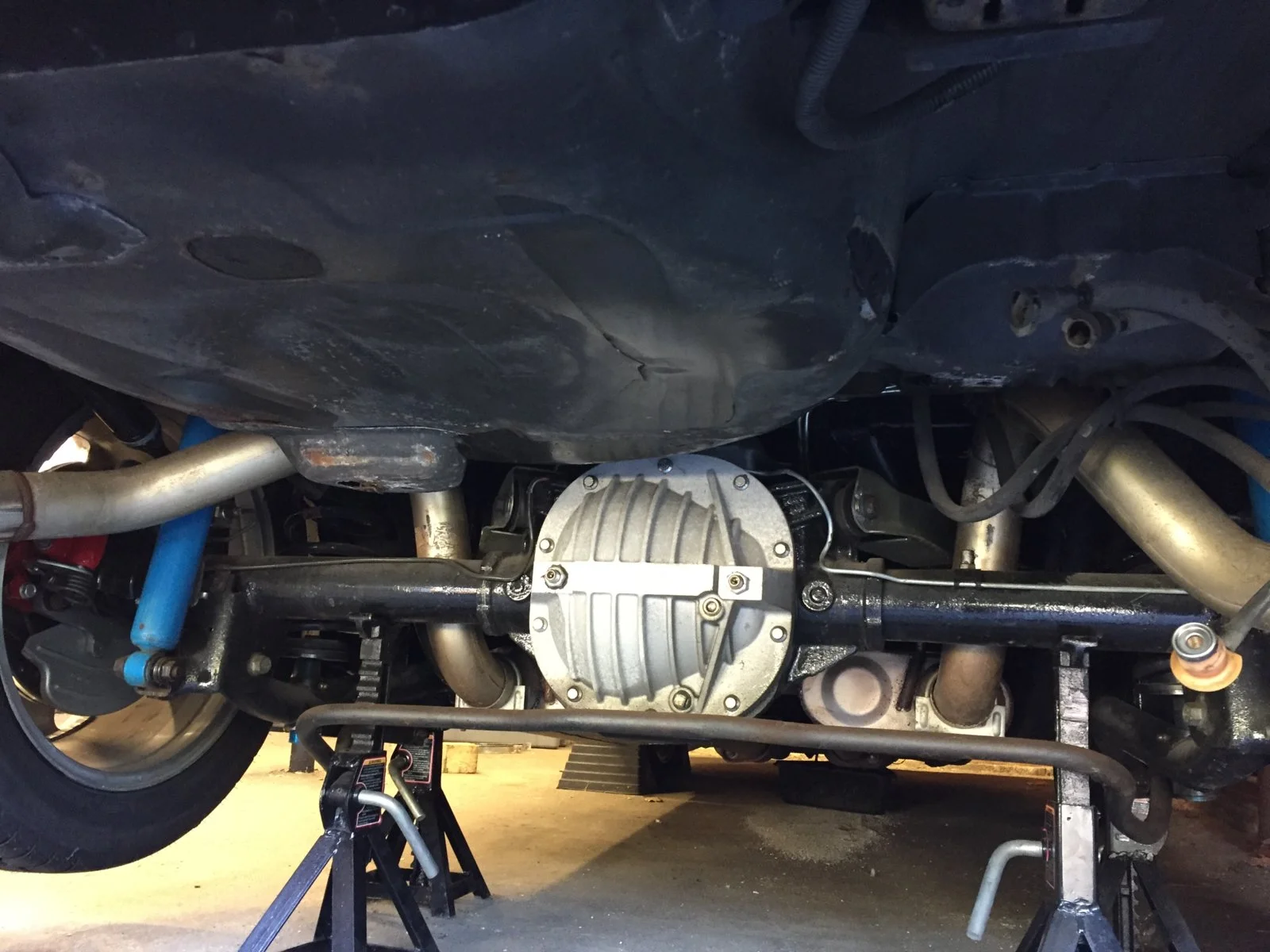

I'm putting the rear swaybar back in.. to finish up getting there rear end all back in... the service Manuel said not to install upside down and the pass side would have a paint mark... I did find a blue strip/mark... I took a picture (attached first one) before I cleaned it up and painted... I also found some pics I took when I got the car before I took apart...
I have it mounted, but I didn't tighten anything yet, my OCD is kicking in... and I want to make sure it's right..

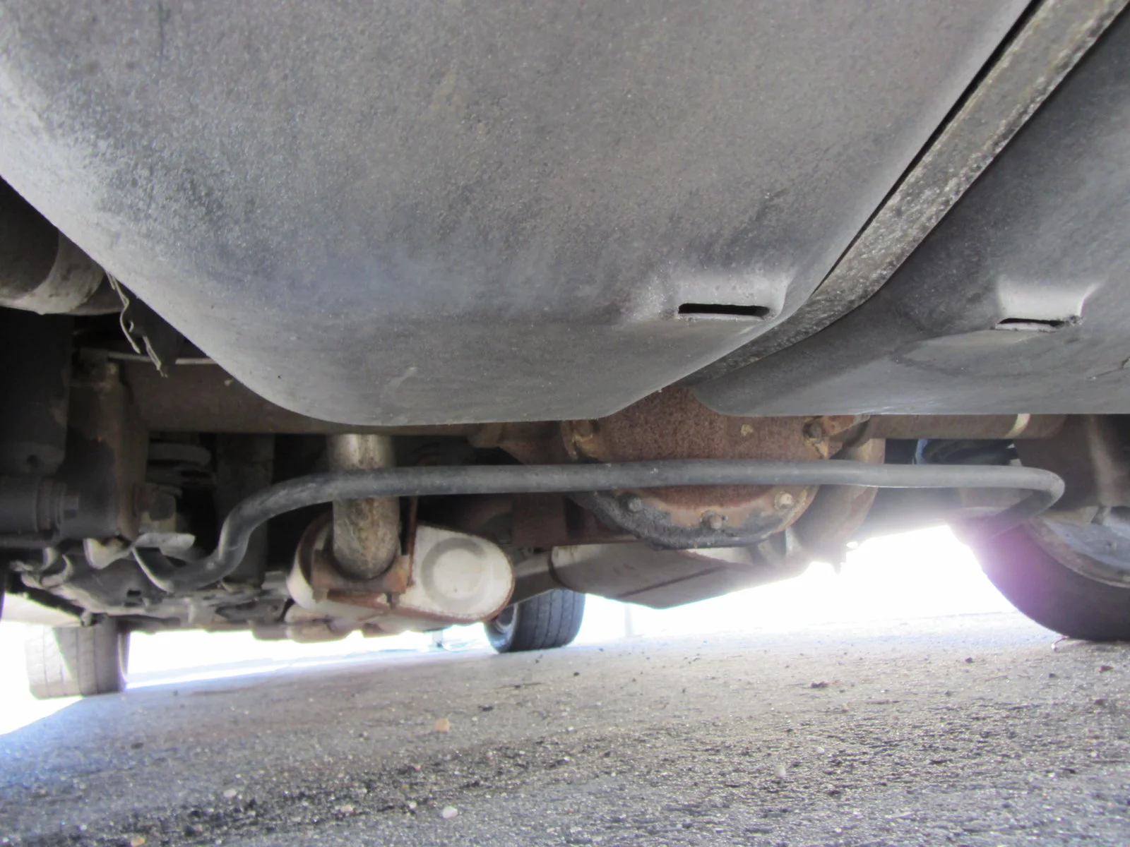

If you look at this old pic (one where it's not nice and painted) it sits higher, then how it is now... I don't know if it's due to the MM lower controls arms making it that way? but I'm 90% sure I have it right...

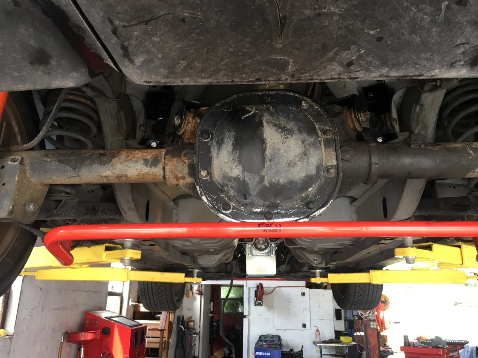

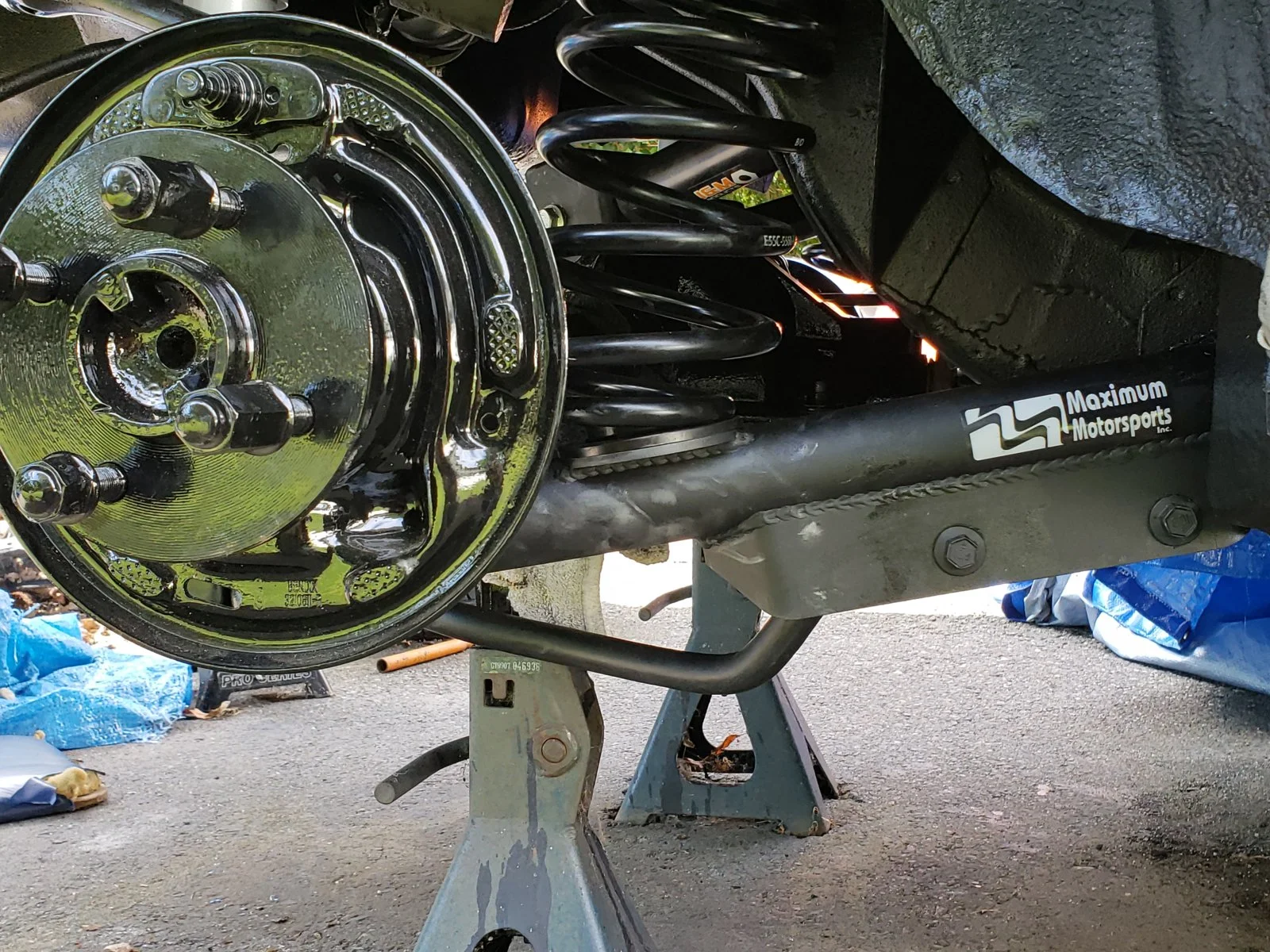

Looks right to me. I looked at 'the stunt double' that has stock lcas and it's the same way. Just to satisfy your ocd place your old lcas up there and you'll see they mount the sway bar higher.
I took it off and flipped it , and it went fit the other way, the way the mm lowers say bar mount has that end that goes in so it keeps the bar from fitting.... I'm just surprised how it hangs down I can see that hitting stuff
