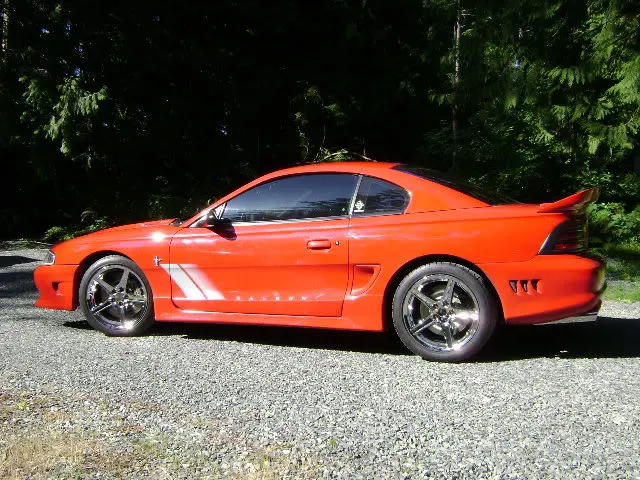

As far as wheels, Im running 18x10 saleens w/ 295/35 out back and a 3/8 spacer along with the Eibach prokit. You must be running a pretty small tire out back if your considering a 1" spacer, cause I know my tires sit pretty flush with the rear panel. I couldnt imagine4 a 1' spacer with the 295's.
Here is how she sits w/ my set up.

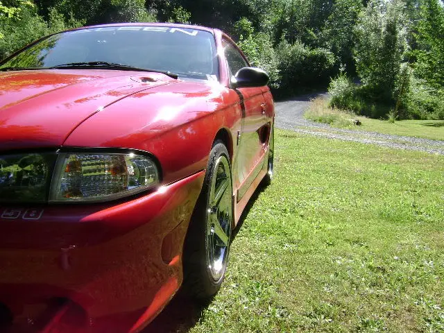

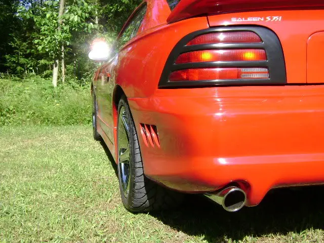

Heres how it looks. Not the best pic's but You can see here how the front is out more than the rear.
This shows how tucked in the rears are.
From this angle it looks O.K. though.
