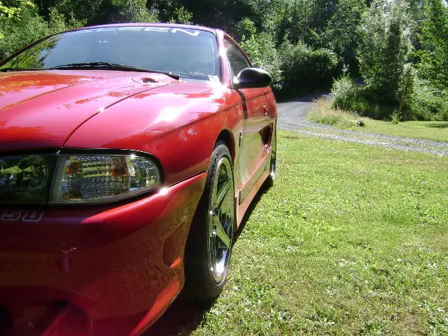

Heres a pic of how the fronts are out more than the rear!
Looks o.k. from this angle though!

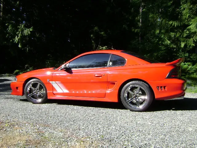

here are the pics, sorry for the wait been a little busy.
Before
After the Sportline Plus system lowering kit with the 1" wheel spacers
(springs still have to set to their final height)
Hope this helped
