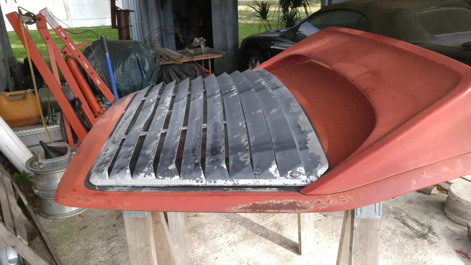

I have real 'installed by Ford' slats to put on the Junk Pyle, so no help here.

I managed to track down some of these window louvers finally, after a long time of searching. But they didn’t come with hardware. I ordered the rear window louver hardware kit from summit racing but i can’t get it to work with these 10 slat ford louvers. Could you please post some pics of the mounting hardware so I can get something fabricated?

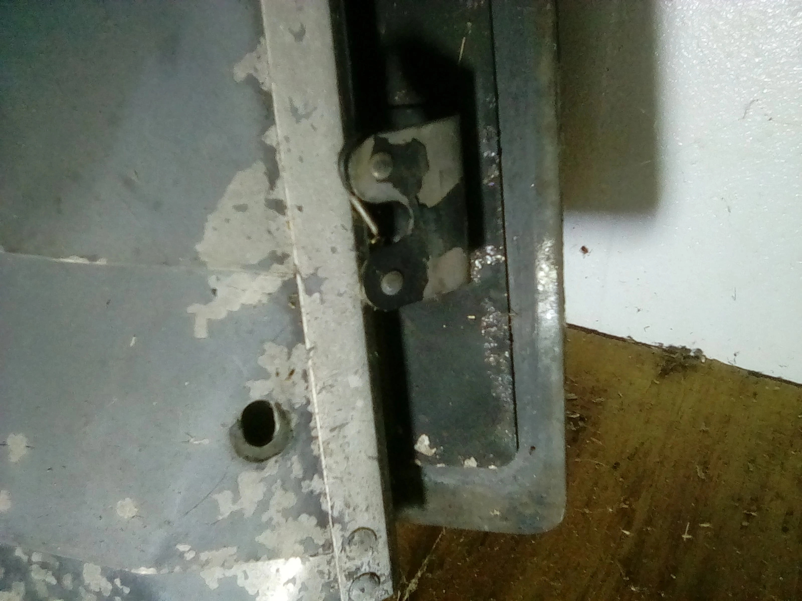

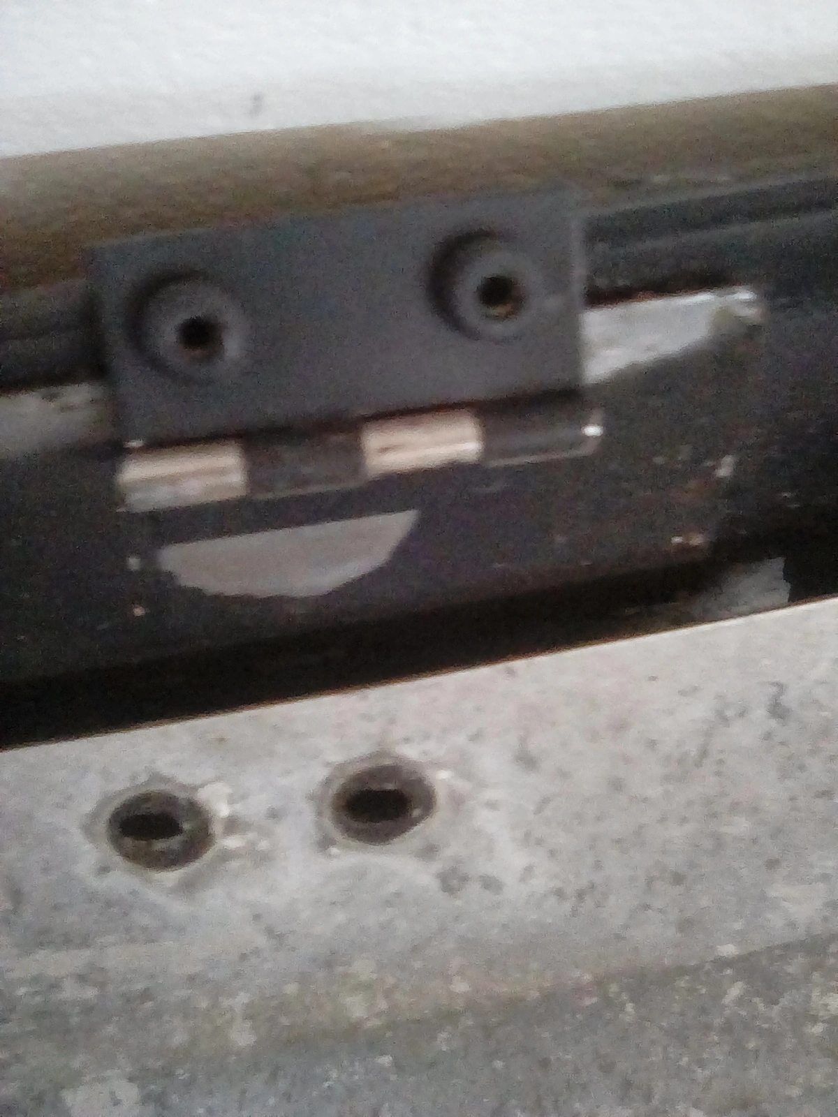

Pics on the kindle are kinda crappy, basically the first pic is the top of the back glass, a very thin piece of metal (tin like?) is glued to the top of the back glass with two hinges with nuts attached, in the pic they are in the 'up' position, the second pic is the lower attachments, again a small, thin metal piece with what looks similar to a 'Dzus Fastener ' that secures the lower part of the slats.

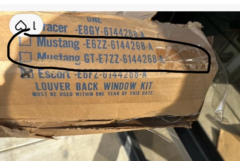

I have not seen a part number on mine but I ain't really looked
Thanks guys…
6144268 seems to be the part number.
I have been looking for them for a while and was curious if the part number was actually stamped on them or not to indicate if they are actually ford or aftermarket so figured to ask being that you guys have them... I never saw the ford ones in person and was curious what to look for if I came across them.. I guess the material they are made of and the amount of slats are the way to tell….

Can you possibly send some pictures of the brackets where the two halves of the louvre bolt together and a clearer picture of the lower bracket?
Thanks in advance, even what you’ve sent already has gotten me one step closer to mounting these to my car. Much appreciated
