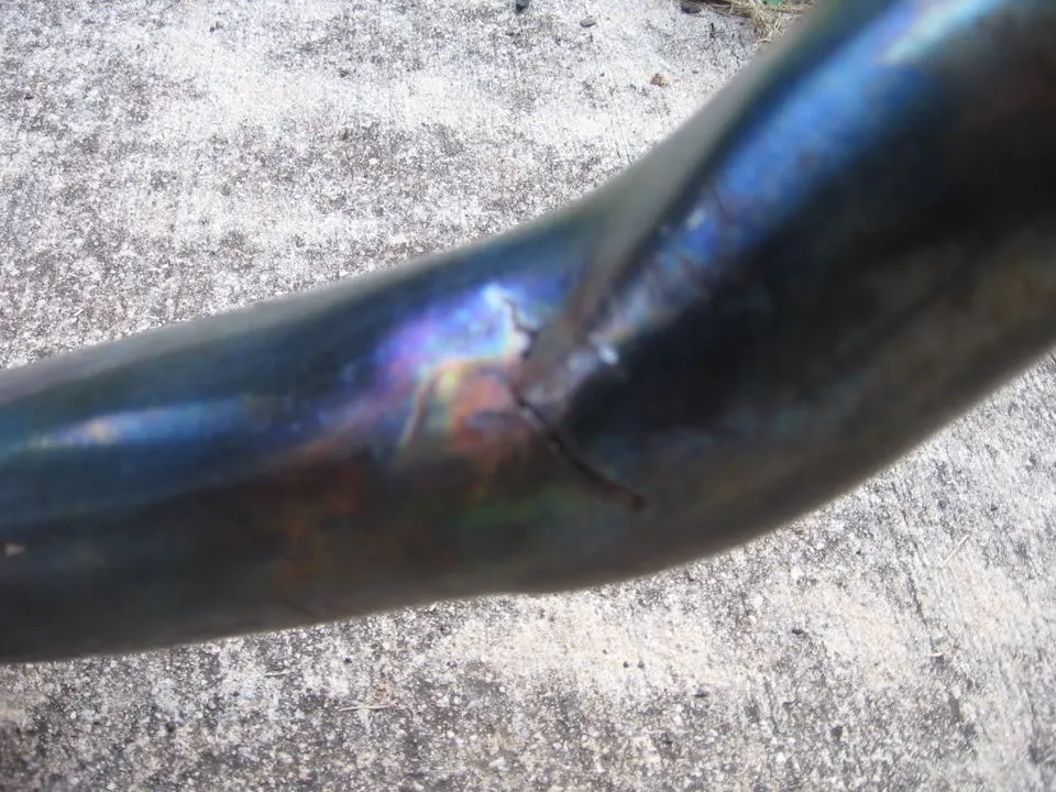

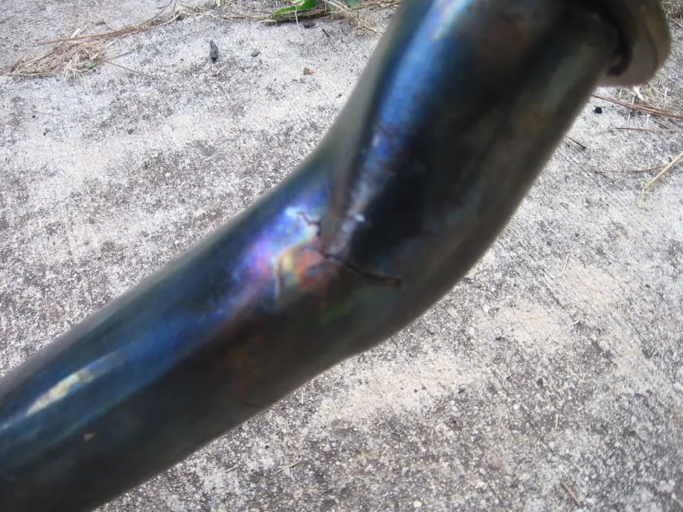

This is why I don't take my car to the shop anymore. My friend took his Cobra to a local exhaust shop to have cats put back in, and here is the result. Someone tried to twist the pipe to make the cats work, instead of rebending it.
Kurt
Yeah, they installed cats on this car about a month ago, and one of them popped after just a few weeks. They wouldn't replace the cat under warranty, because they said there was something wrong with the car that caused it. The car runs like a raped ape with no check engine lights or anything. When I got under there, I found out that they had only run the smog pump line to one cat instead of both. In addition to the crack in the pipe, I think we found out what was wrong with the car. They also insisted on removing the H crossover to make the cats fit, when there was clearly plenty of room up the pipe to fit them in.
The car has since passed GA emmission, so we went ahead and put in a BBK long tube and X-pipe combination. I have some old cats off a 93' Mustang. I'm just going to make my own H-pipe for that once a year event.
Kurt

Oh damn...yeah and i assume thats the cat that didn't have the air tube on it?
Yes. That will kill it too. They will brick up on you in NO time. You dont need all that crap on there to pass emissions. You can just get cats that dont require "air."

I really ought to put up pictures of the rest of the pipes so you can really see this abortion job they did. All the pipes are shoved in at funny angles, and I think it was the mechanics first day with a welder.
