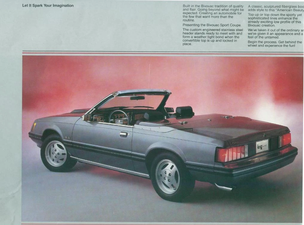

To the OP. A picture of your car will very quickly determine if it is a factory '83 and on vert or a coach built custom (they have a very unique look to them - very similar to the ASC McLaren verts.
Here is an image of a '79-82 coach built vert.
The almost flush tonneau over the retracted top is the give away of a coach built vert.
