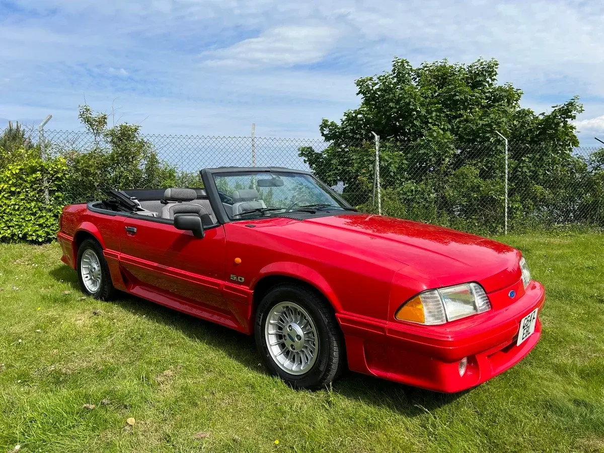

Hi there, I just bought a convertible 1990 GT Fox Body and am having a little mechanical touching up done etc. Next project in the New Year is Camming it. The engine is completely stock at the moment and I was hoping for some guidance on what camming options I might have? Any thoughts greatly appreciated!
