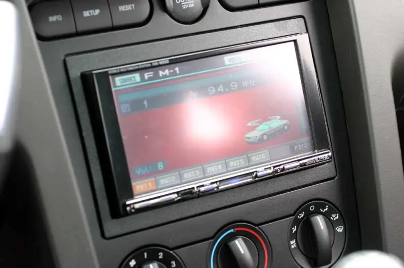

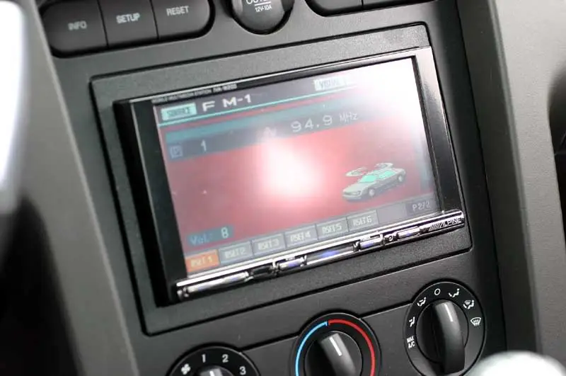

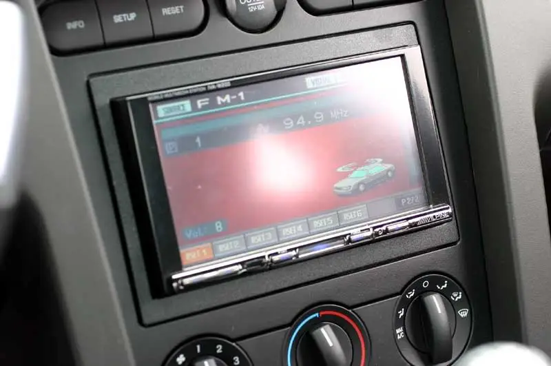

if it wernt for the price i would recomend the one i have and its the alpine iva-w200
